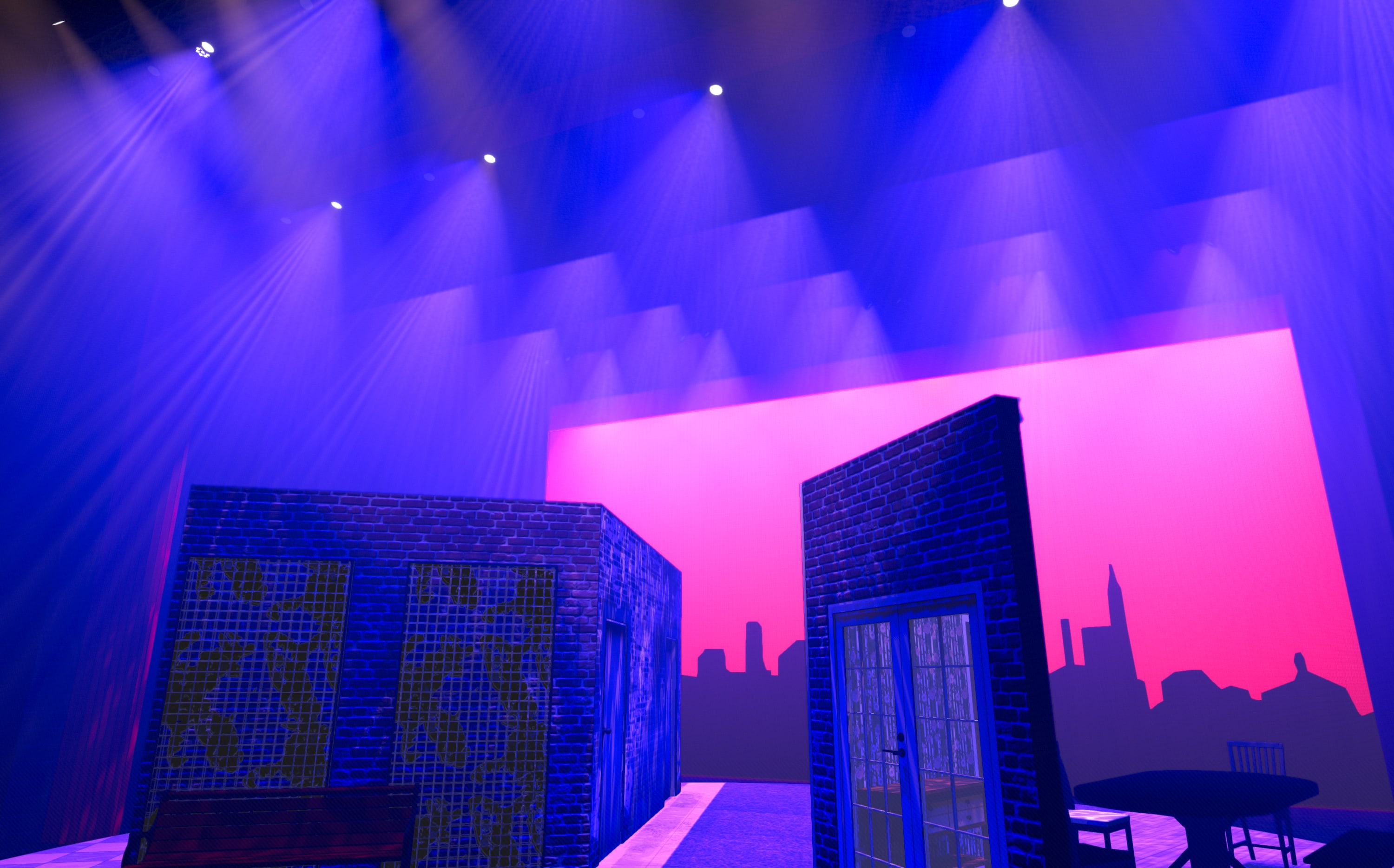

9. Advanced Fog and Background Control
Showcase is the only place in Vectorworks Spotlight where you can set Fog values below one or use fractional settings (like 2.5%). Adjusting the Fog slider in Showcase Preferences changes the amount of fog in your selected Renderworks Background, and you’ll see the effect live as you work.
showcase fog
For a dramatic outdoor night scene, try a Two-Color Background with a dark top color (like black) and a very dark blue bottom color.
two-colored background showcase
