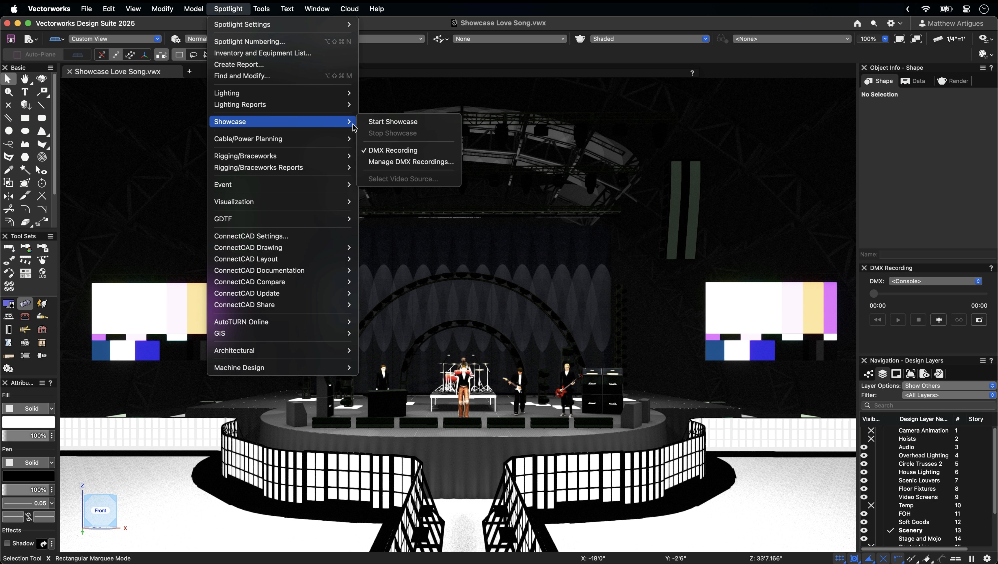

The Start and Stop Showcase command under the Showcase menu dropdown allows you to enter and exit the Showcase Shaded Render mode. Once you start Showcase, your properly configured lighting and video screens will respond to income data from lighting consoles, external video sources, and PosiStageNet controllers.
Lighting devices simply need a GDTF or Fixture mode assigned to them in the Object Info Palette (OIP) before exporting as an MVR to a console and matching DMX patch.
opening showcase in vectorworks spotlight 2025

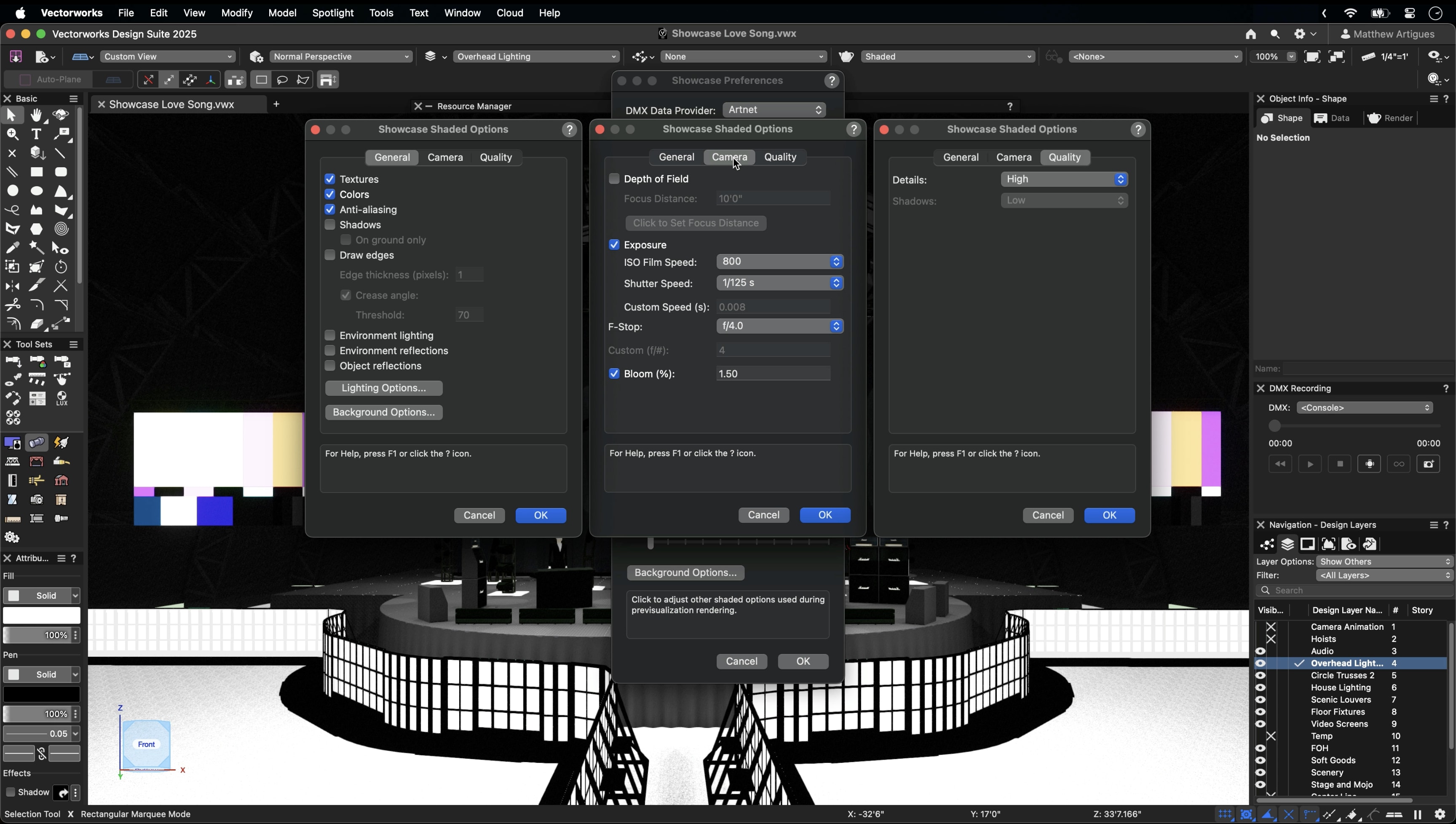

Next, under the Spotlight Settings menu, you’ll find the option for Showcase Preferences. Showcase is based on the Shaded Render mode which is standard for model rendering, but Showcase has its own set of rendering settings, letting you fine-tune your previz for the best results.
Your options within the Showcase Preferences dialog include:
  • DMX Data Provider – this allows you to select MA-NET3, Artnet, and sACN as the incoming data stream from either a physical or virtual console.
  • PSN Origin – this option allows you to set the X, Y, Z origin points of your external PSN control software.
  • Render Options – there are render options for hiding lighting geometry, enabling shadows, and controlling the ambient brightness. Adjusting these settings can speed up the performance of your previz.
  • Lighting Options – this option gives you the ability to set specific lighting rendering options like Brightness, Ambient Occlusion, and Environmental Lighting.
  • Rendered Background – this can be changed along with Background Options to enter the Edit Dialog for your select background.
  • Lit Fog – this enables fog in the rendering with the option to adjust its level of density.
showcase preferences
Showcase Shaded Options opens a dialog where you can set your Showcase Shaded Options to their own parameters, further enhancing your previz. For best results, you need to activate Exposure and Bloom under Camera settings.
showcase shaded preferences

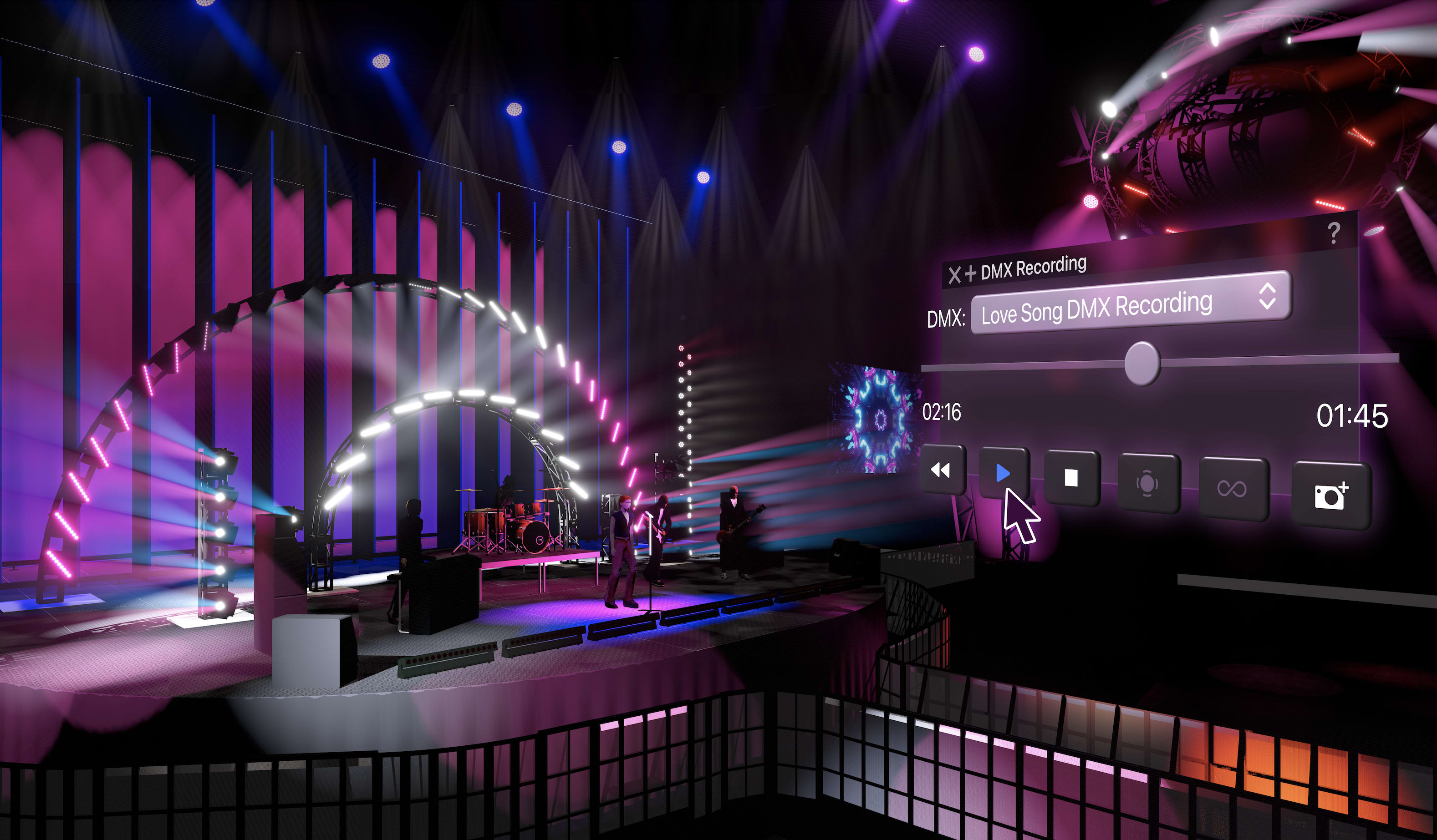

Next, there’s your DMX Recording Palette found under your Showcase menu. This palette has easy-to-use controls like a traditional media player, including Rewind, Play/Pause, Stop, Record, Loop, and DMX Snapshot.
There are three options under the DMX dropdown. The Console listens for the DMX Data Provider that you have assigned under Showcase Preferences. There’s also a section for any DMX Recordings and Snapshots currently in your active document. Finally, Manage DMX Recording shows you all associated recordings in your file, their duration, and the ability to rename them. Recordings can be imported out of or exported into your file, too.

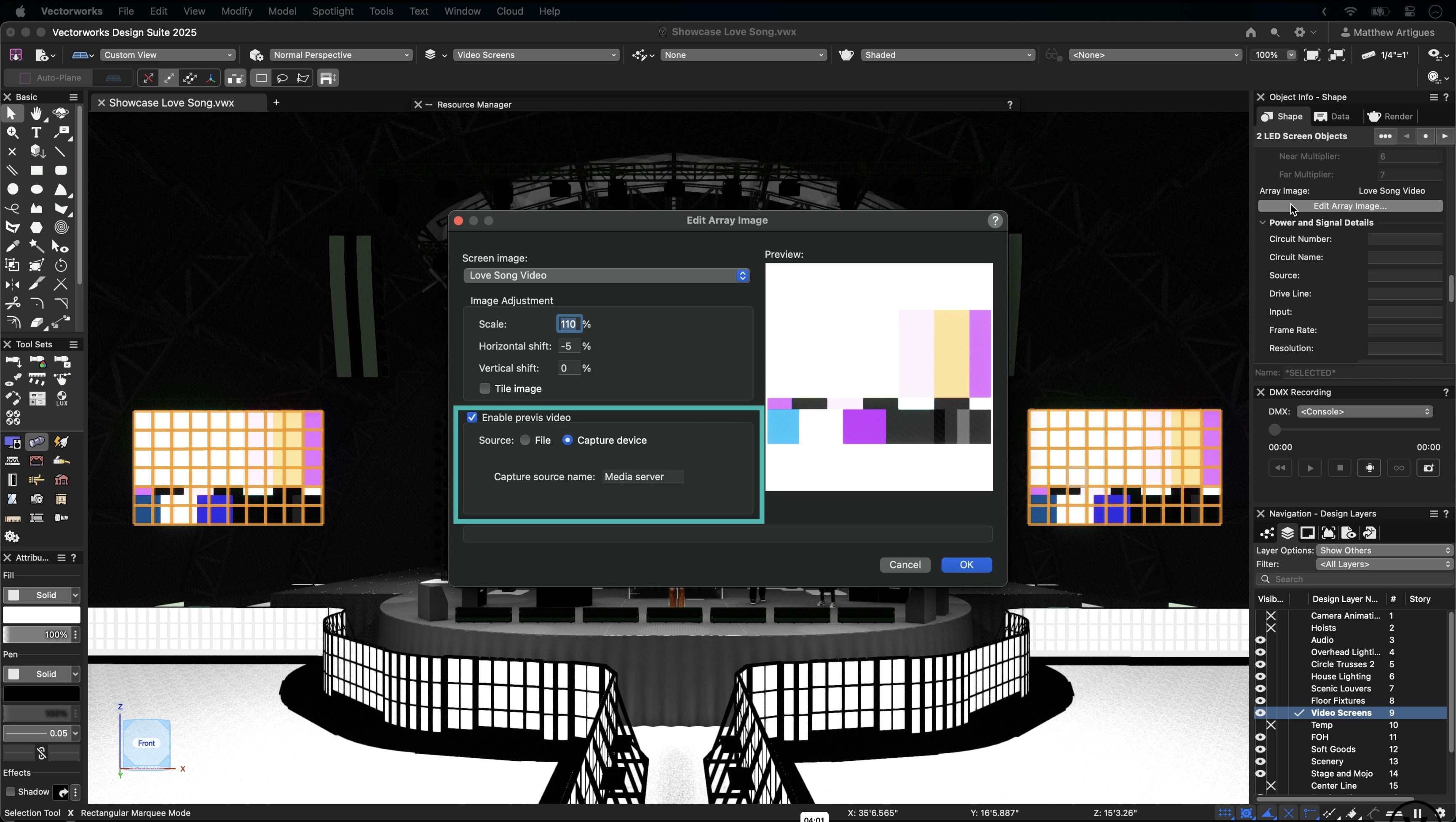

With Showcase, video parametric objects can have video files associated with them. After pressing Edit Screen Image in the OIP, check Enable previz video and select the file. Once Showcase is started, the video begins to play and will loop.
edit array image
As a tip, make sure that the attached video is sent along with the Vectorworks file if it is shared with others. NDI sources can also be associated with these objects by entering the name of the capture device and using the Select Video Source command in the Showcase menu.

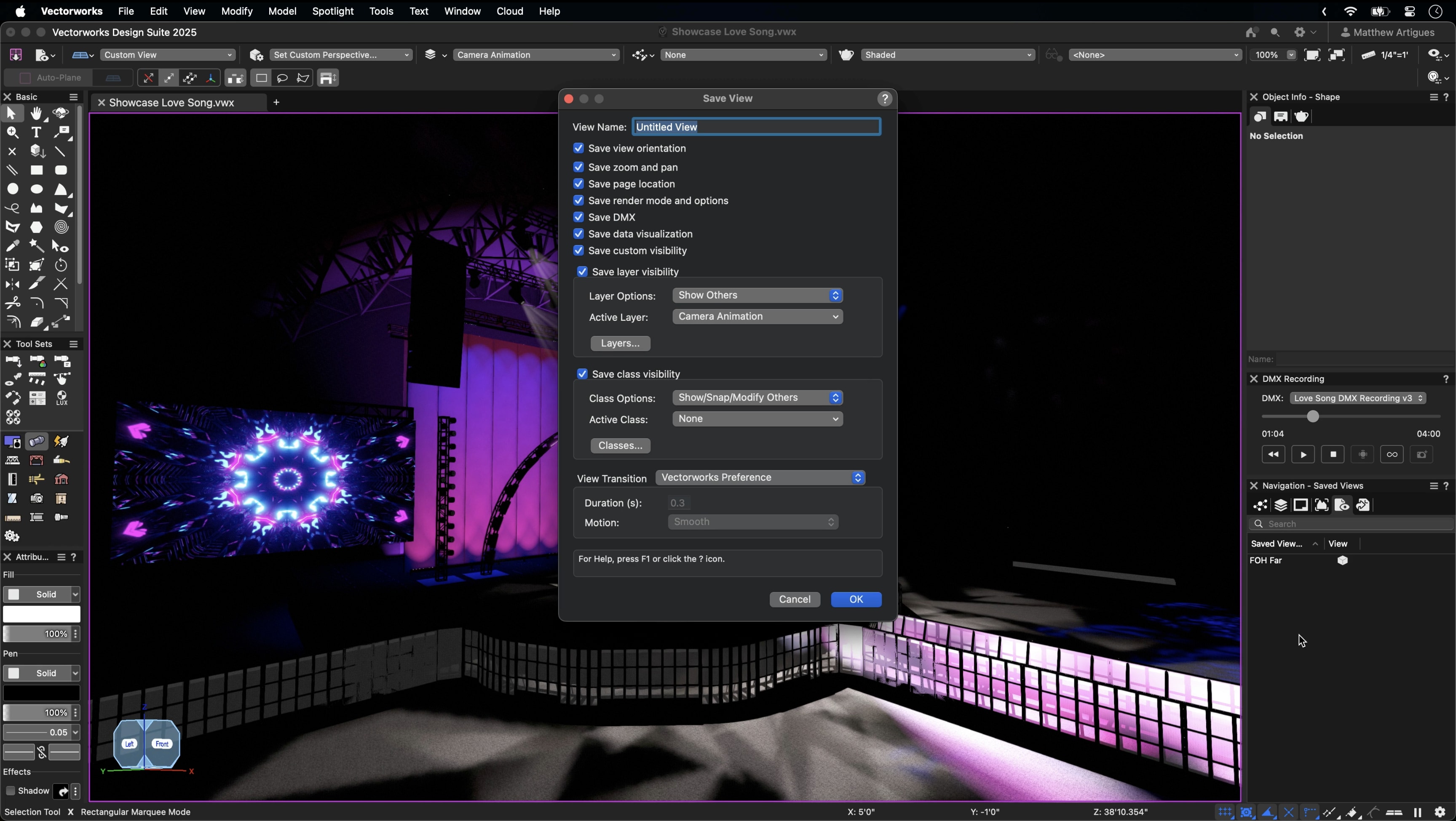

DMX transforms and PSN with objects in Showcase are handled by attaching an associated record format to that object and the data and signal routing matches on the control software. Saved Views also interact with Showcase and any incoming DMX streams in a similar fashion to DMX snapshot. The Save render mode and Save DMX options look for an active DMX recording or console stream to grab a portion of the information to create the Saved View. If live DMX is coming into the file and you create a Saved View with DMX, a DMX snapshot will also be created.
save view showcase

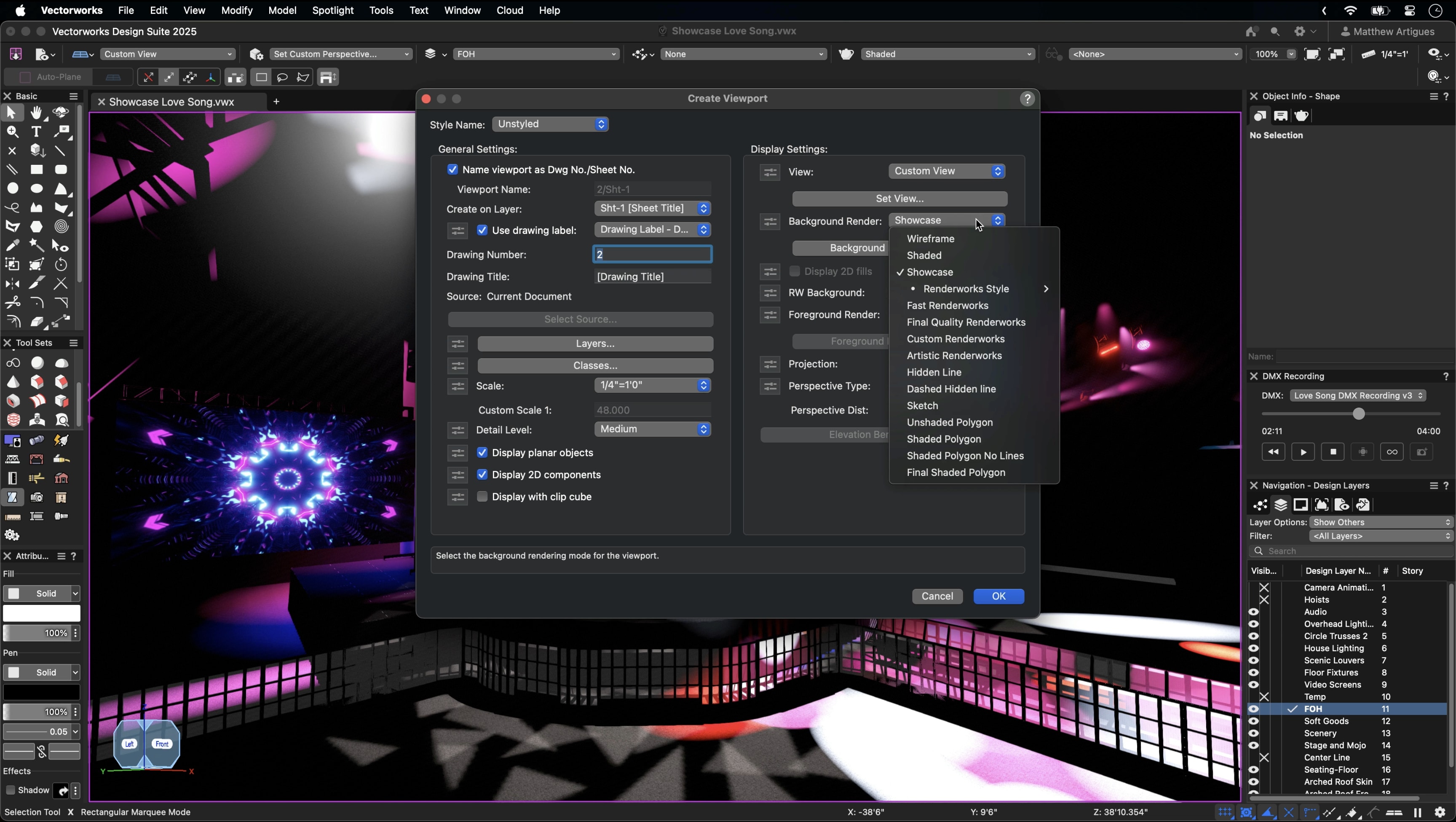

Sheet Layer viewports can also be created in Showcase from the Create Viewport command.
showcase viewports
