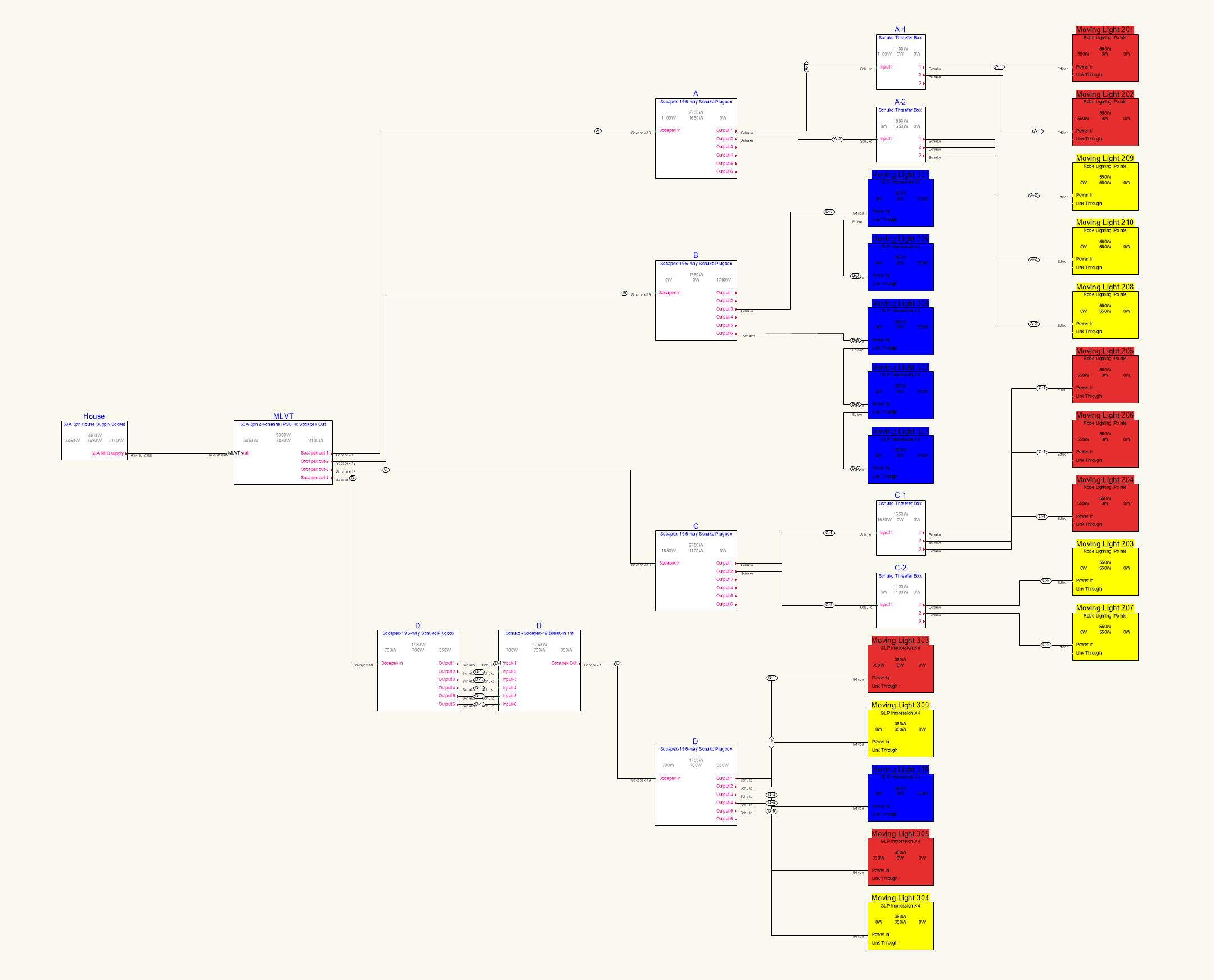

Power Schematics in Vectorworks Spotlight for Power Planning
Now, let’s look at ways to get more out of power schematics. Power schematics help your power planning process by giving you an easy-to-read, diagrammatic overview of the power and how it's laid out.

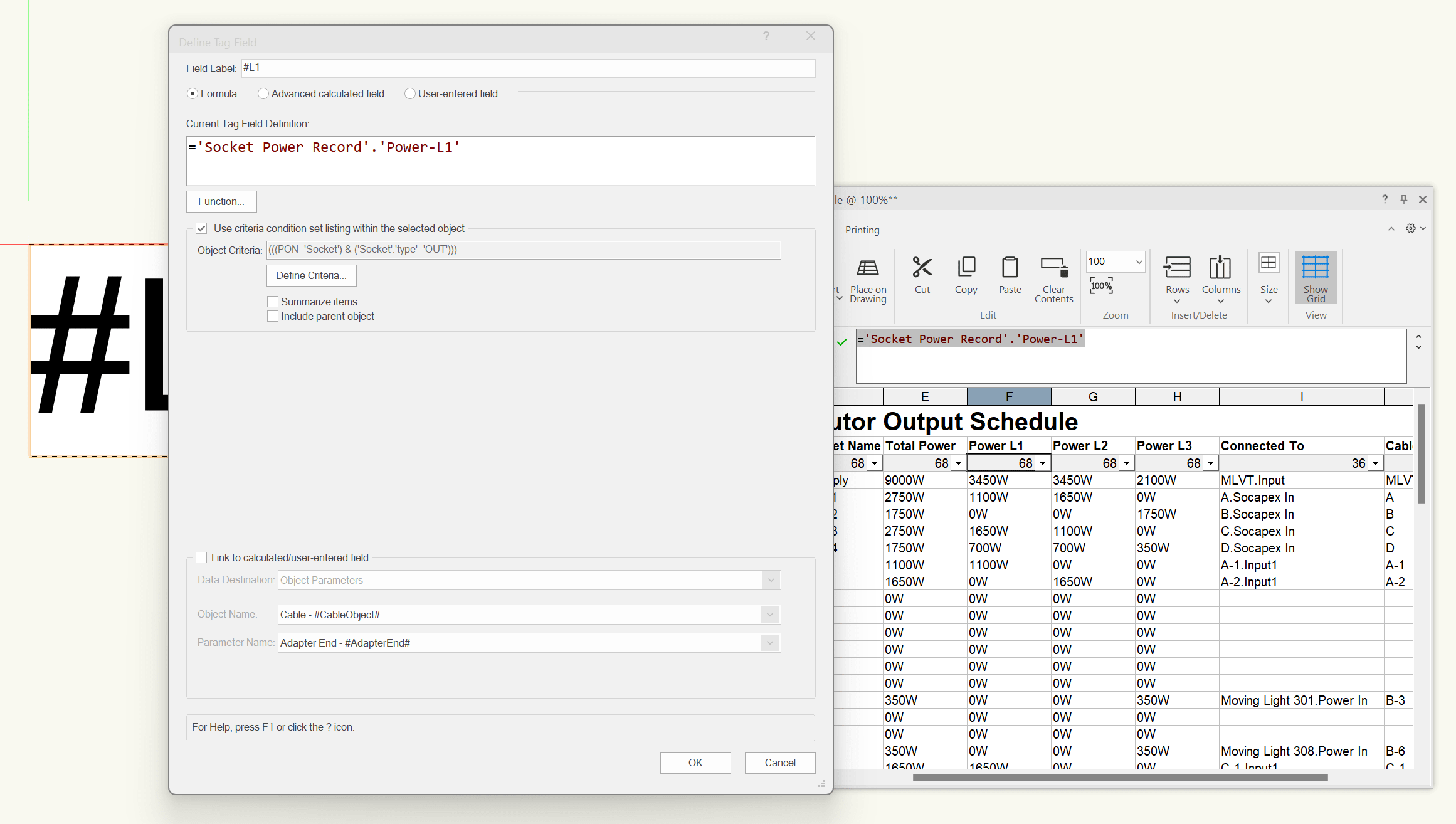

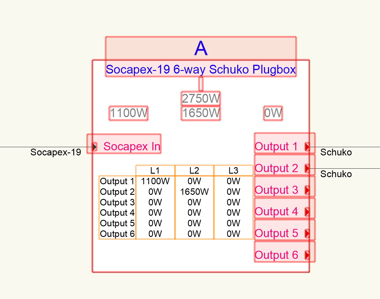

First, use Data Tags to display your breakout circuit loading. Start by selecting a schematic device using the Create Data Tag Style command. Add some active text for each phase and set it to use formulas.
You can copy the needed formula from the database column headers in the Spotlight Distributor Output Schedule worksheet in the Resource Manager. Then, set the tag to target output sockets in the criteria of the active text.
circuit load

You can also add Data Visualizations to your power schematics to display phase loading or positions. These visualizations make the schematic much easier to read for your on-site crew and collaborators. You can keep multiple data visualization schemes active simultaneously; just remember that the order you activate them determines the order in which they apply to your schematic.
power schematic 2
