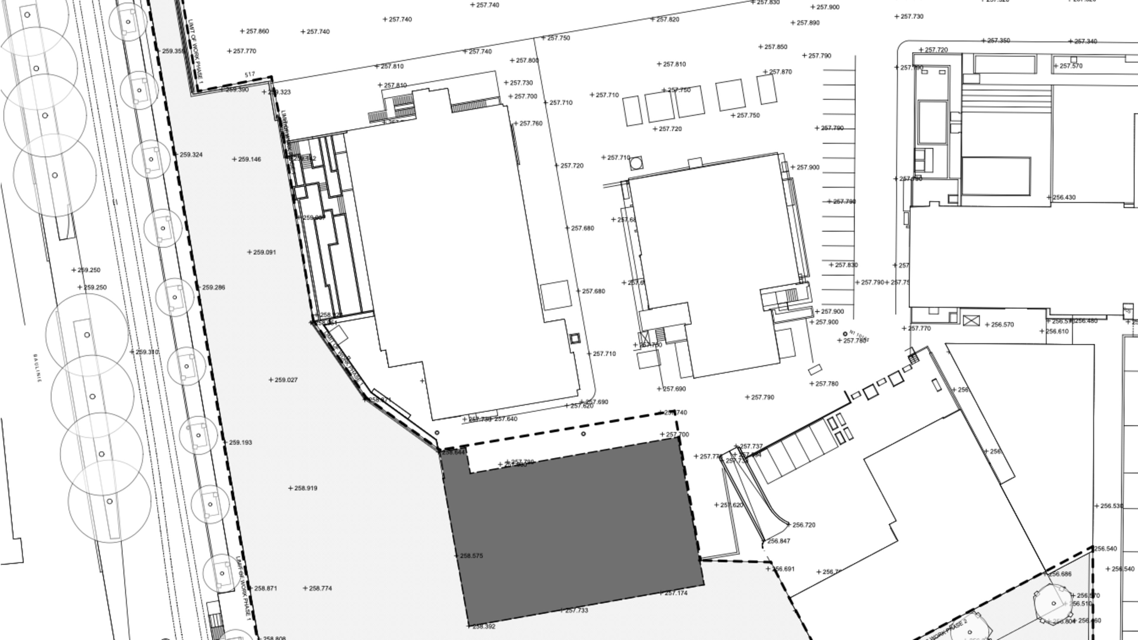

Buildings don’t exist in a vacuum. Often, demolition plans need to account for the land on which the building is built. Having access to a site plan gives you the base you need to properly plan for your demolition project’s impacts on the surrounding site.
Site demolition plans often include:
These site considerations are critical for safety, compliance, and coordination, especially on tight or urban sites.
