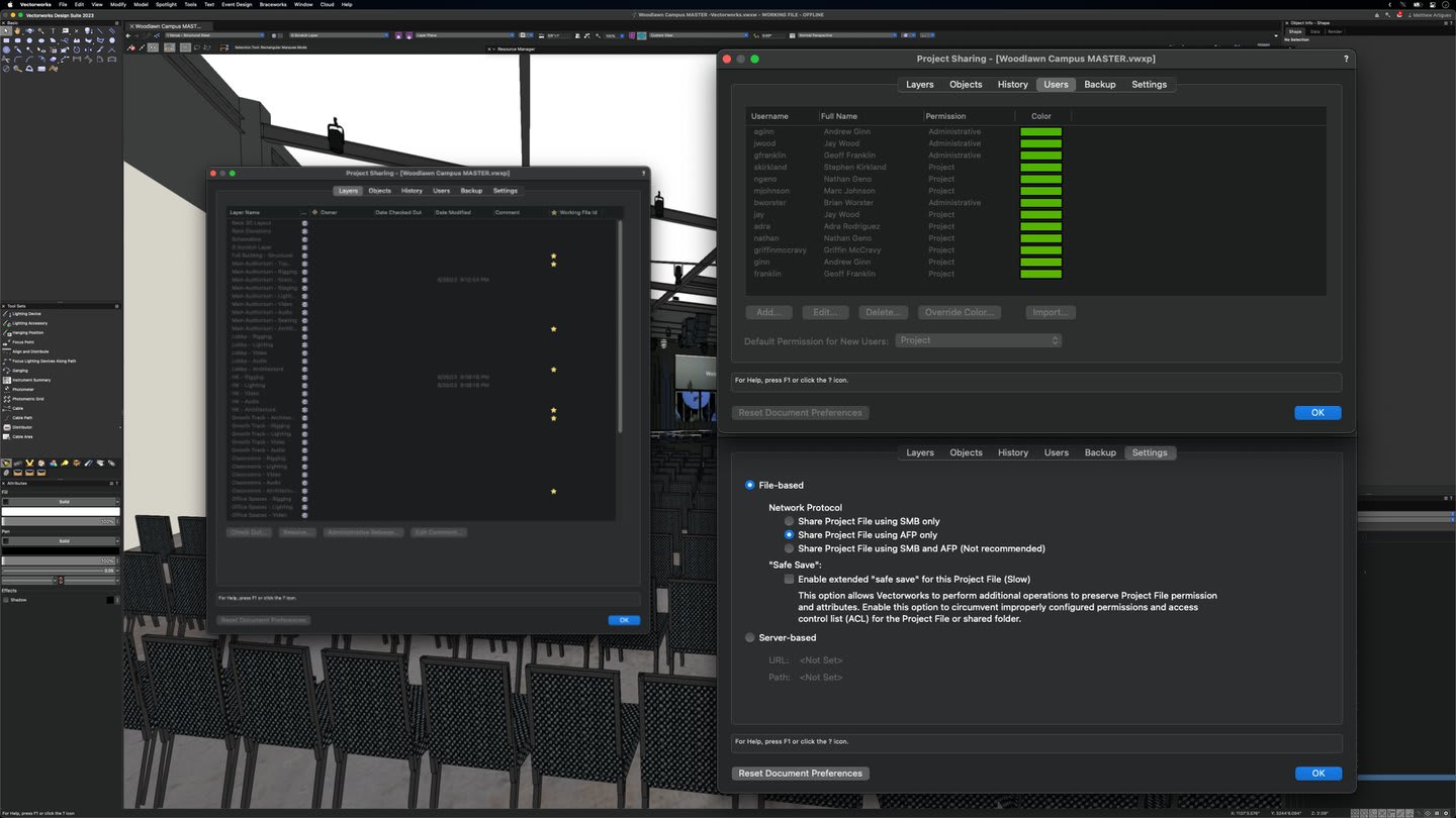

This use of dedicated layers in a single Vectorworks file is made possible with Project Sharing. Project Sharing is Vectorworks’ multi-user environment that allows you and your teammates to work on the same file at the same time, no matter where you are in the world.
Once in the specified layer, basics such as walls, doors, windows, and other key components of the structure are added to the file. Each of Franklin’s designers will then create a Working File using Project Sharing to build out the production’s audio, lighting, stage, and video components for the worship services.
Project Sharing, according to Franklin, helps him and his team make sure all the questions and potential hiccups of a production are figured out before it’s presented to the Church of the Highland’s leadership.
Project Sharing

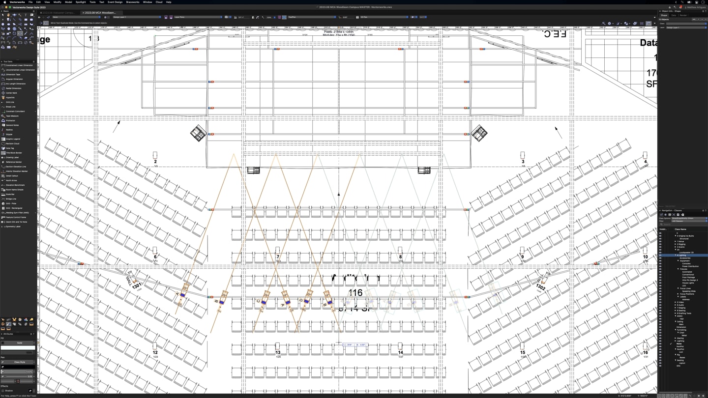

The Align Plane and Mirror tools, for example, are maximized for lighting, audio, and stage design. Since the Church of the Highlands’ stages and rigs are symmetrical, the crew can save time by only designing half of the rig’s pipe grids and staging before mirroring them down the center cord to the other half of the design grid.
Mirror Tool

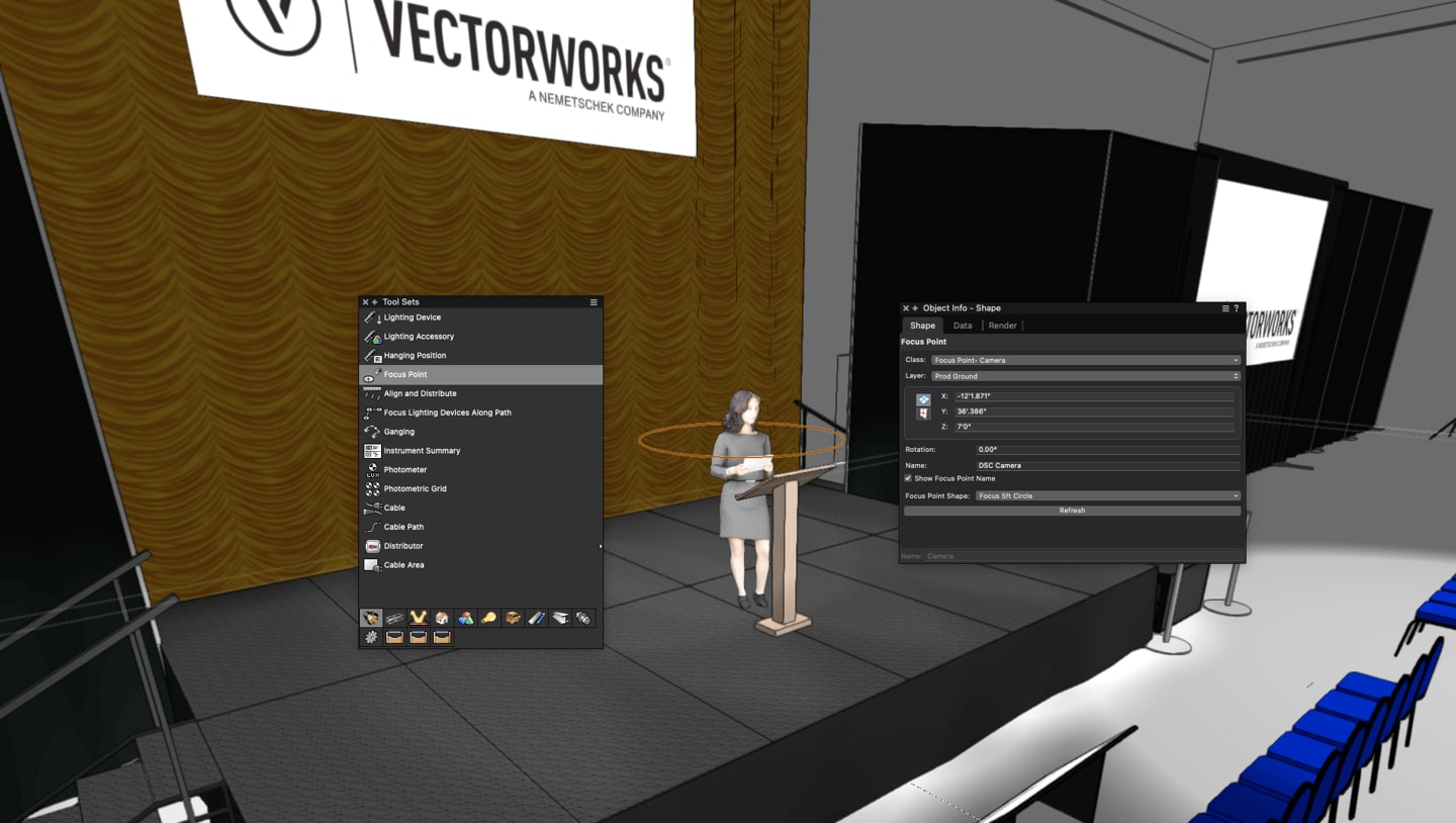

There’s also the Focus Point tool, which Franklin and the team use when setting up conventional fixtures for a render and with moving head fixtures over a stage when capturing design concepts.
Franklin also recommends using the “great” Focus Point tool to build solid front washes.“ Placing points at vocal or speaking positions at head or chest height can help you find potential pockets or troublesome hot spots in your wash. Having that information in the back of your mind when it comes time to meter and set levels is very helpful ,” the designer added.
Focus Tool

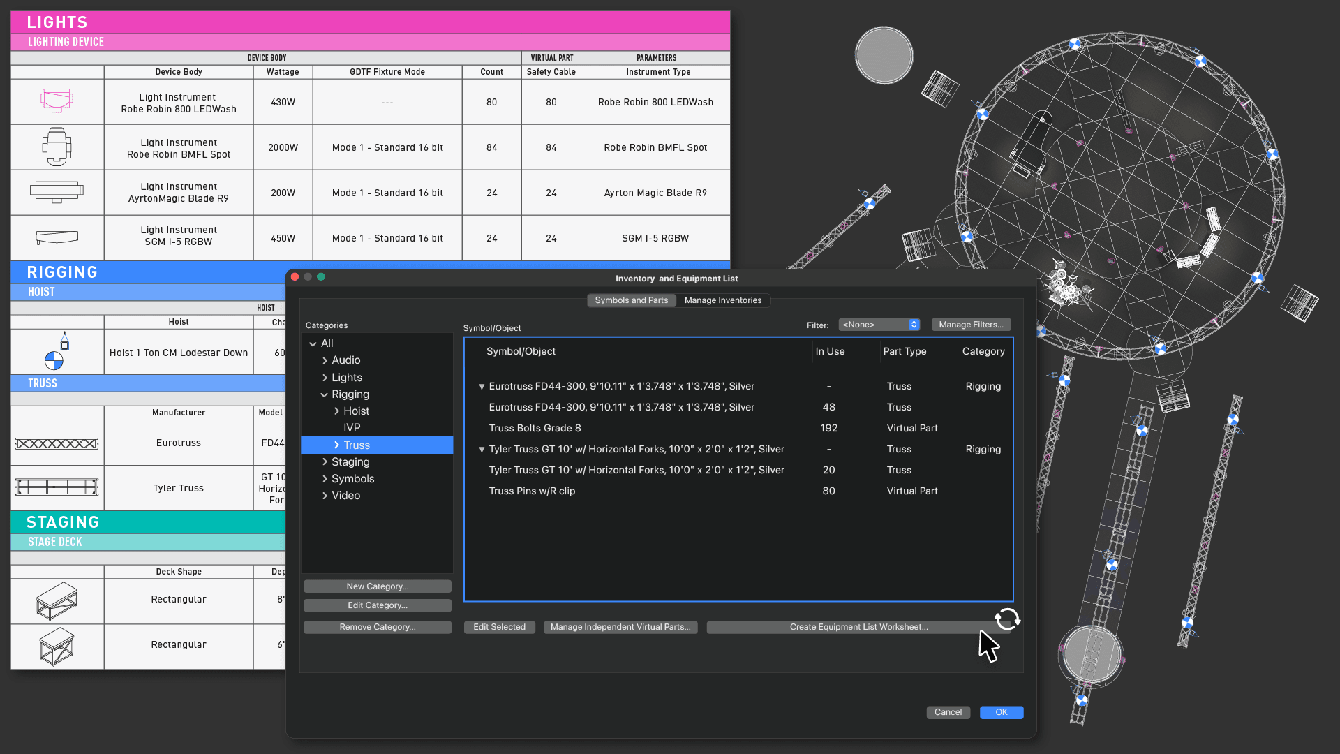

With the Equipment Lists you’re able to consolidate and track all the Spotlight objects within your file. These objects are then tabulated in one (or multiple) report that can be taken and customized to your needs.
Plus, the new “Inventory” system helps you centralize equipment owned by you or your vendors, creating a digital inventory right inside Vectorworks Spotlight.
Equipment-Lists
