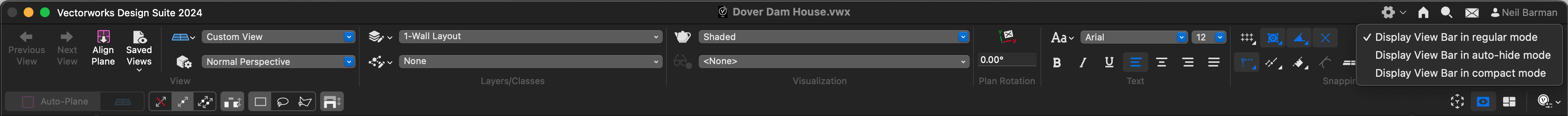

Customizing the View Bar & Mode Bar
4a_View_bar_mode_compact
4a_View_bar_mode_regular
The View Bar in Vectorworks offers three modes: Regular, Compact, and Auto-hide. By adjusting these modes, you can determine the number of controls visible and the amount of screen space they occupy. This customization allows you to tailor your workspace to your specific design needs, enhancing efficiency and productivity.
In addition to adjusting the modes, you can also pin and unpin controls in the View Bar, meaning you can choose to display only the controls you frequently use in your design workflow, hiding the ones you don't need. This not only streamlines your workspace but also creates a visually cleaner environment. You can even toggle View Bar group labels on or off as desired.

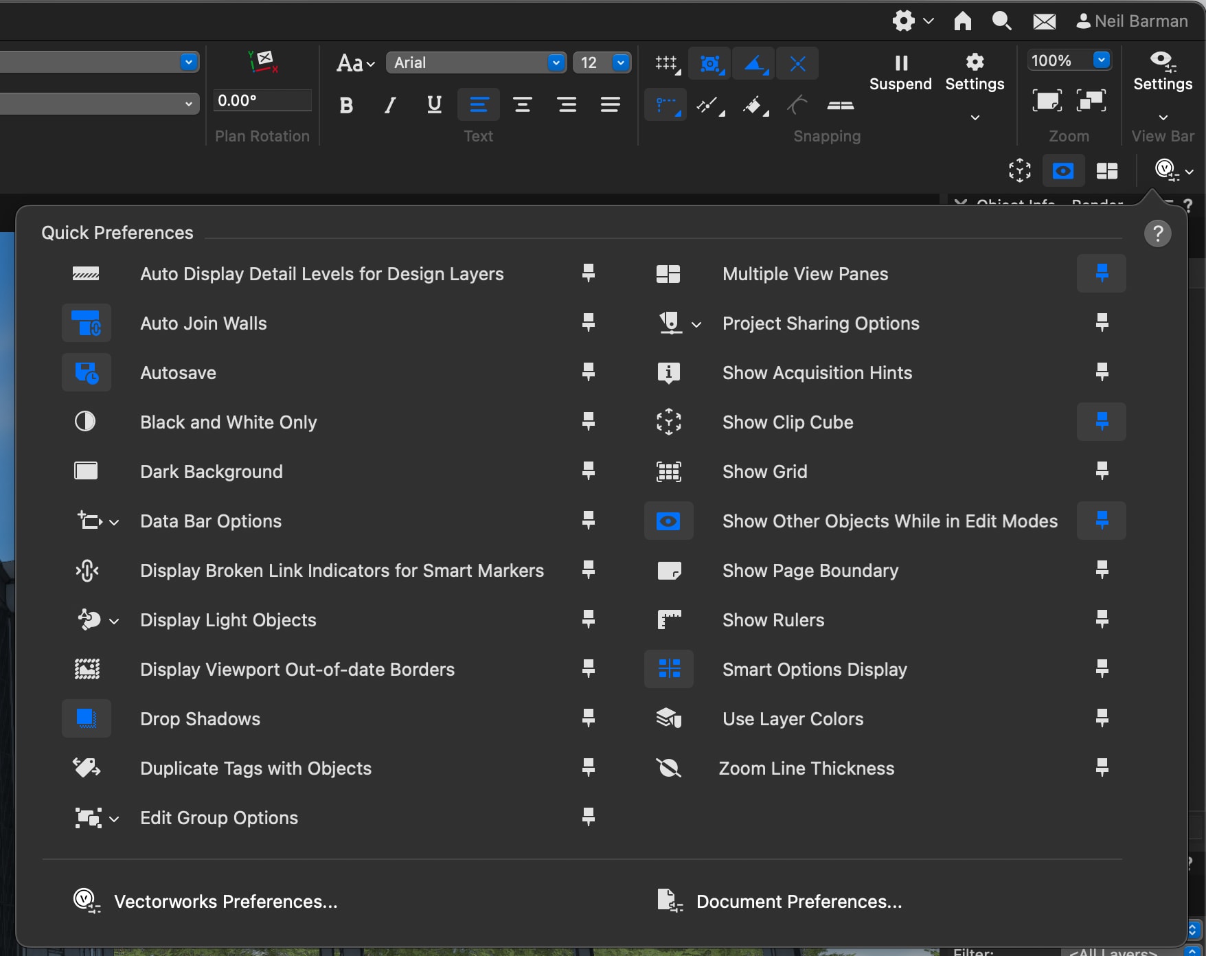

Another useful feature is Quick Preferences, which allows you to pin and unpin frequently used preference buttons on the Mode Bar. This gives you quick access to preferences that you often need to change. Additionally, you can toggle preferences on or off directly from the Quick Preferences setting pop-up, eliminating the need to navigate through Vectorworks Preferences. These customization options save you time and ensure a smooth and efficient workflow.

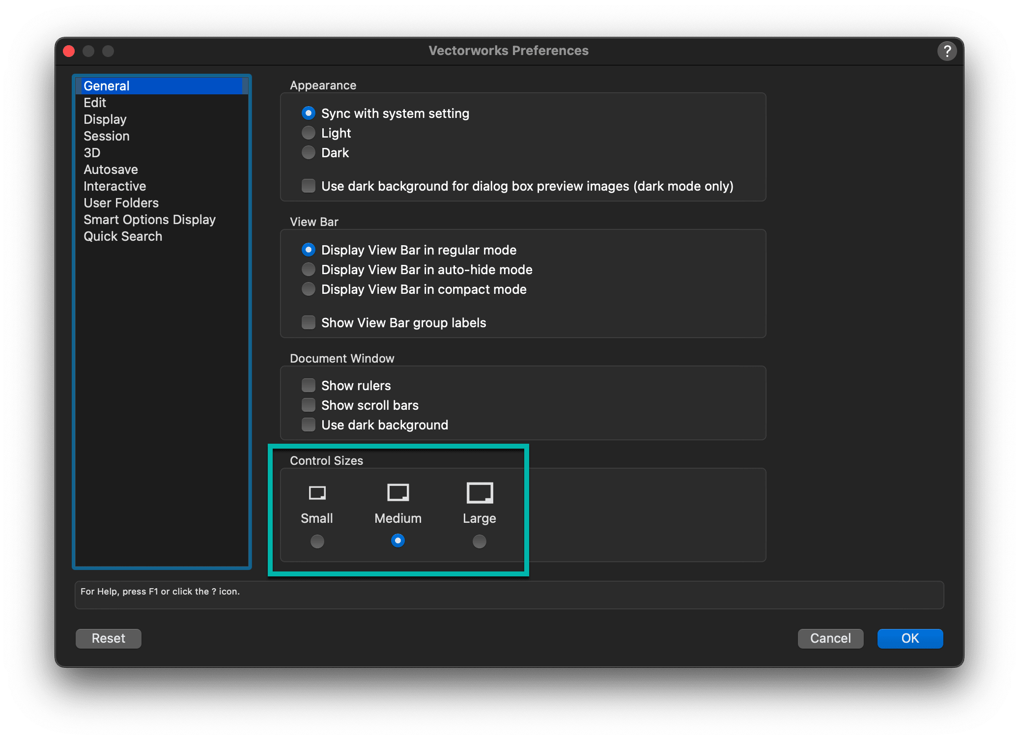

Scalable UI on Mac allows you to adjust the control sizes, including icons and fonts, based on your display preferences. Whether you're working on a laptop or a desktop with an external monitor, you can customize the UI to suit your needs. For example, you may prefer smaller controls when using your laptop and larger controls for better visibility on a desktop.
It's worth mentioning that the redesigned icons in Vectorworks now feature clean and crisp graphics, enhancing the overall visual experience. These redesigned icons are optimized for both light and dark themes, which are available on both Mac and Windows. The introduction of a dark theme for Windows in 2024 adds even more visual versatility to the workspace.

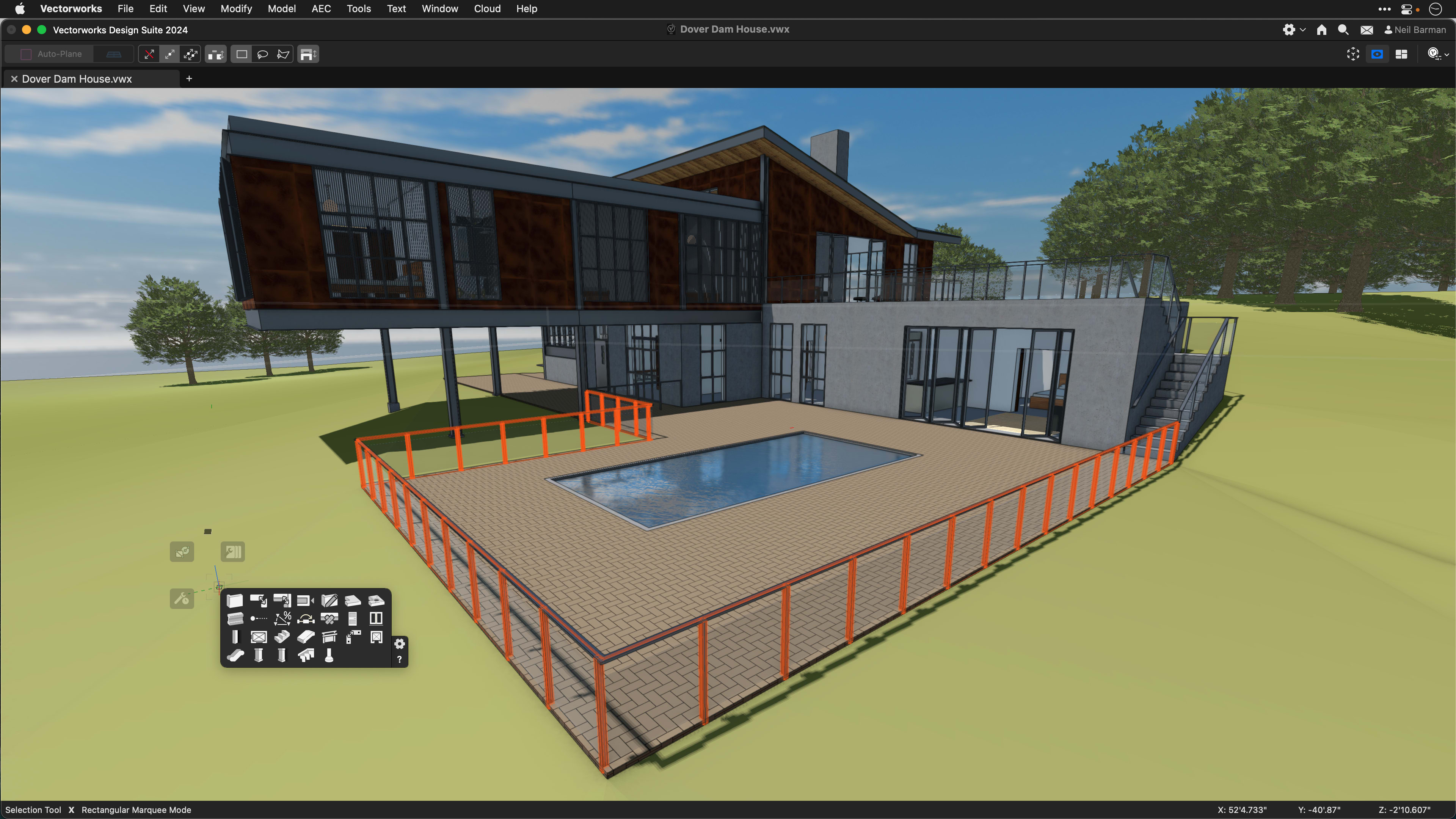

Auto-hiding docked palettes provide a valuable option for maximizing your design space. When your palettes, such as the tool palette, Object Information palette, and Navigation palette, are docked to your Application Window, enabling "Auto-hide docked palettes" under Window > Palette Options will automatically show and hide palettes as you interact with them. This feature ensures that your design space remains clutter-free, offering more room for your creative work.
7_Workspace_example_3_dark
Docking Frequently Used Toolsets
Tearing off and docking often-used tool sets allows for seamless workflow transitions. By default, Vectorworks provides a main "Tool Sets" palette with various industry or task-related tool sets nested within it. However, if you find yourself frequently switching between these tool sets, you can tear off any set and dock it separately. This customization option enhances efficiency and saves you valuable time.
