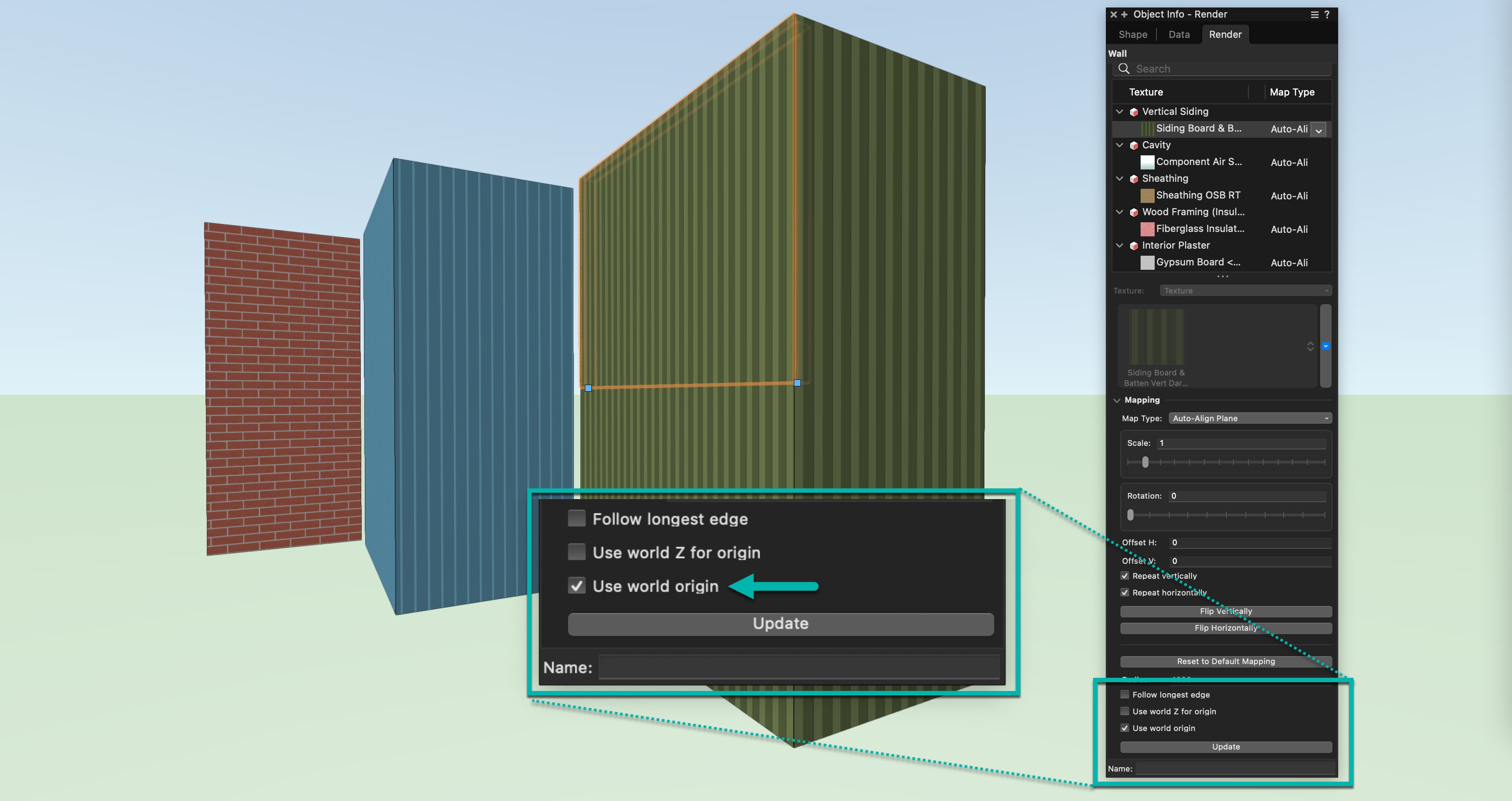

As part of our overall Wall Improvements, we introduced an option for wall textures called “Use world origin,” which can be found in the Object Info palette. Let’s dive into it.
WHAT IS THE “USE WORLD ORIGIN” FOR TEXTURES Option?
Using this option reduces the number of manual adjustments needed for offsets of textures per object.
When you have an object selected, you’ll find this option in the Render tab of the Object Info palette. The button,“Use world origin,” will adjust your texture in the X, Y, and Z directions so that it aligns across different objects.

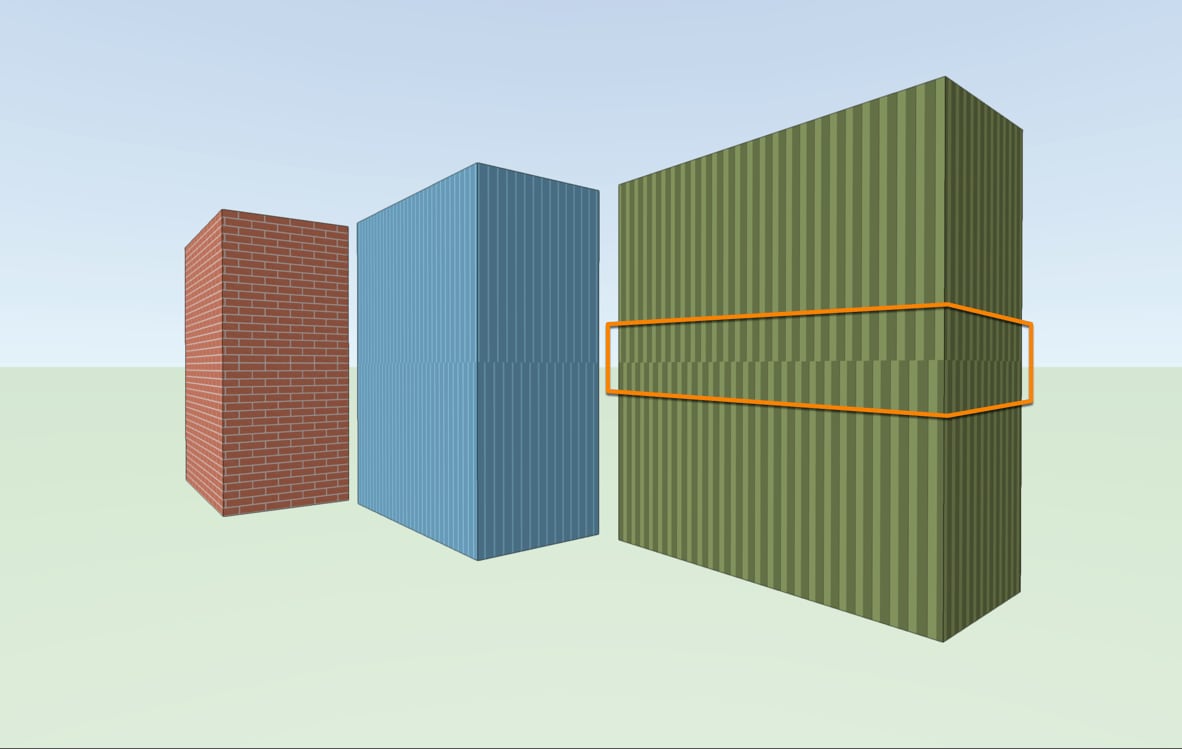

Texture_alignment_2022_and_prior
Alignment issues without new option selected.

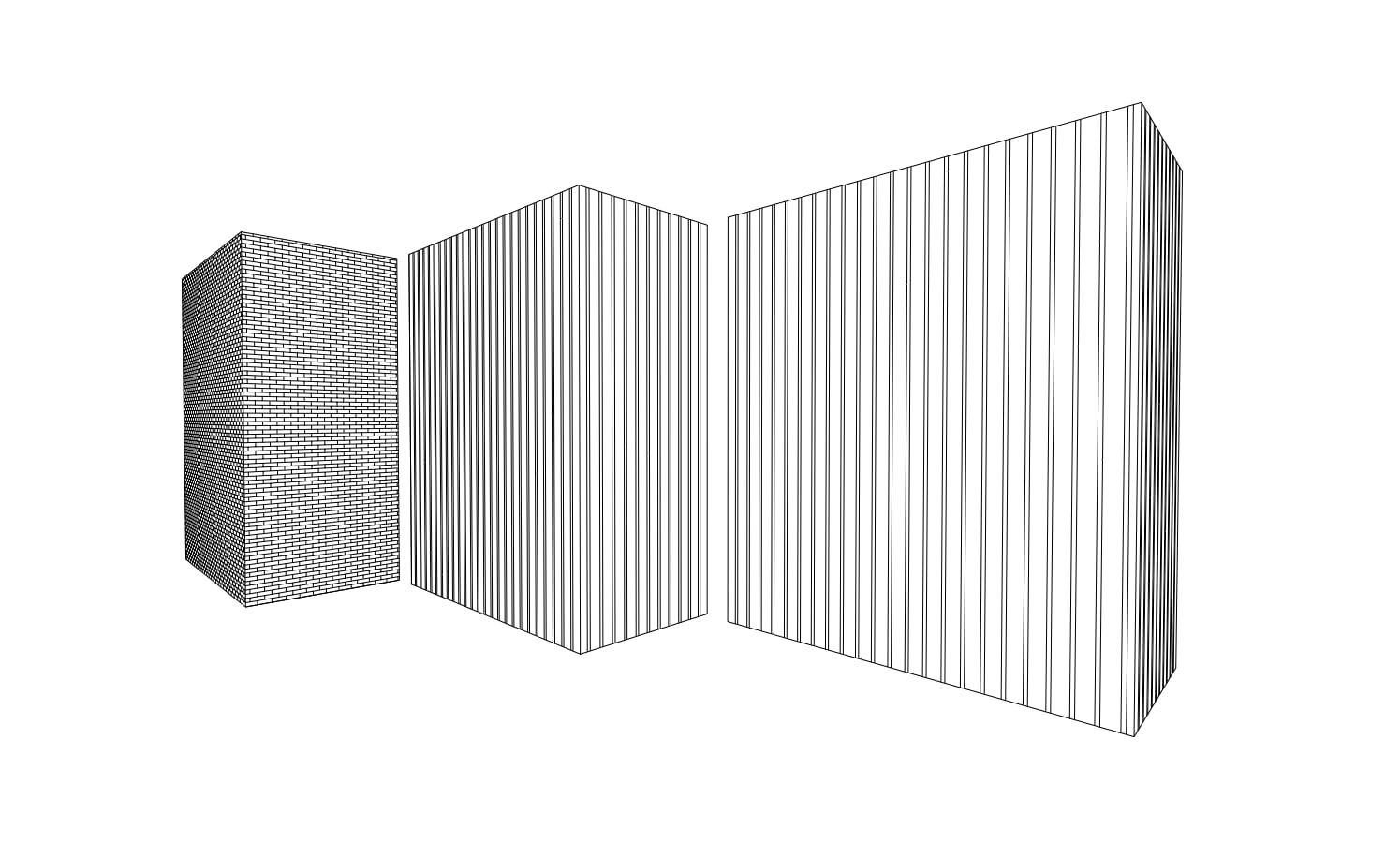

This option works for surface hatches of Renderworks textures as well.
Aligning_textures_now_HL
Texture alignment in hidden line render mode.
In renovation projects, existing and new conditions may require different objects to show what was there and what is being added. While these are two different objects representing existing and new, they may have the same material or texture. Therefore, you’d want all the identical textures to align in rendered views. This option does exactly that while allowing you to avoid manually aligning your textures.
