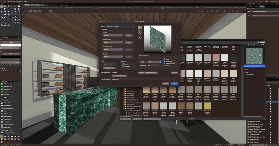

The Resource Manager is your best friend for design development.
If you’ve followed the process so far, your file should contain generic geometry that represents the project’s overall vision. Using the Resource Manager’s extensive library of content, you can start to replace and refine generic object styles by adding specific materials and manufacturer items. This saves you the time from having to redraw these objects with new object styles.
You can use the Resource Manager to maintain folders that contain objects, styles, materials, and other resources that you use frequently. Using pre-defined object styles for objects such as stairs, railings, cabinetry, walls, and windows is a massive time saver. And the objects already have information embedded within, so it’s easy to pull information into worksheets and reports. When you edit an item that’s styled, all instances of that style are updated automatically, saving time.
Replacing the generic styles and components grants you the ability to create accurate quantity takeoffs and analyses of energy performance.
