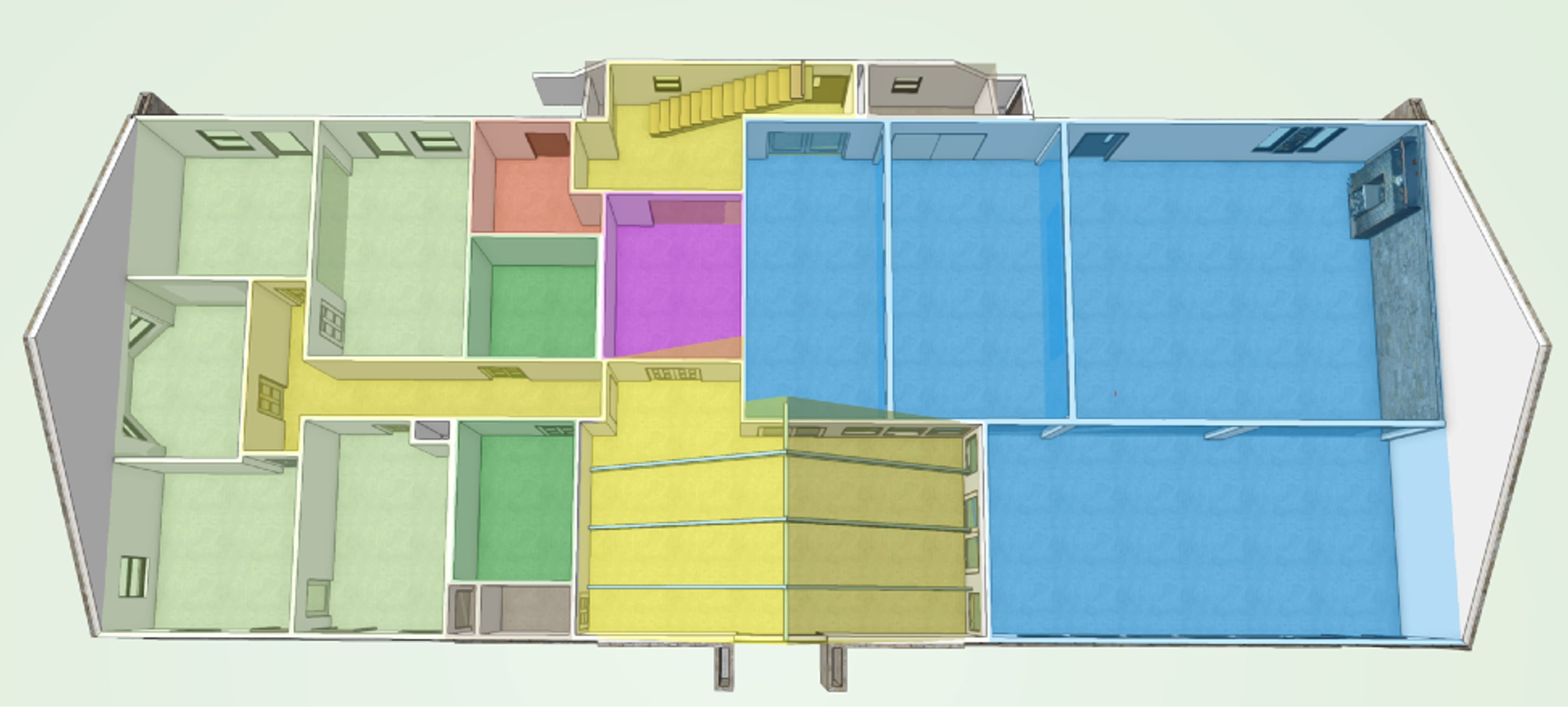

For programming purposes, we added Space objects to the as-built model using the automatic boundary feature. Then, we developed a worksheet within Vectorworks Architect to tabulate the net floor area of the existing spaces. We intended to use this floor area to compare to the program we were simultaneously developing with the parish from our stakeholder meetings. From those programming sessions, it became clear that, to accommodate all the functions the church community was hoping for, the current building was too small by about 2,000 gross square feet. At current construction costs, our rough estimate was that their total program would exceed their initial construction budget by nearly a factor of two.
data visualization in Vectorworks Architect
A “dollhouse” view of our as-built model, with Spaces rendered in transparent colors by function.
