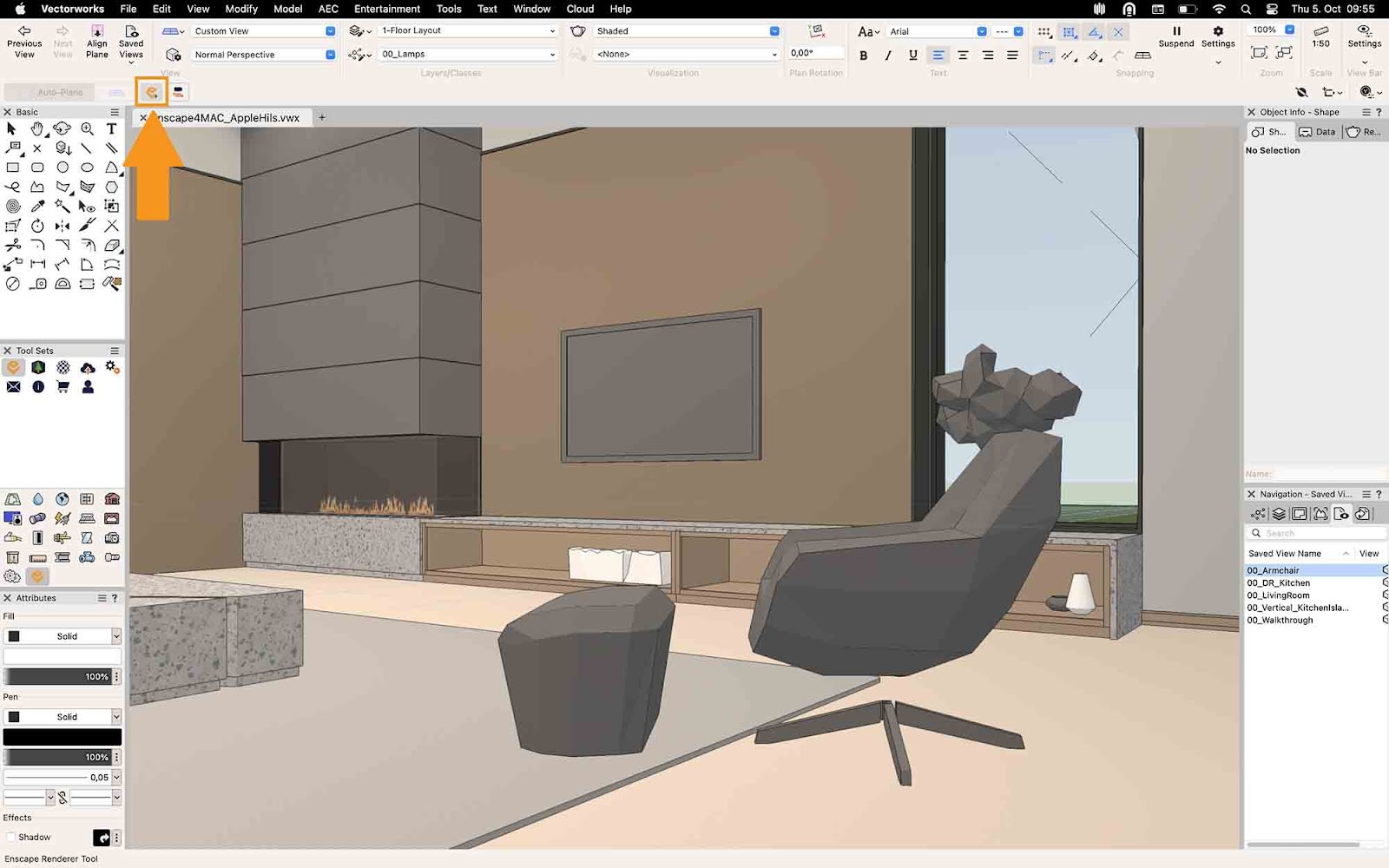

To enable Enscape when opening Vectorworks the first time after installing the plugin, start Vectorworks with any model of your choice or even an empty scene. Go to Tools > Third-Party > Enscape > Add Enscape to your workspace.
Now you should see the Enscape icon in your Tool Sets palette. Selecting it will open the Enscape Tool Set, containing various icons to access and control further parts of the plugin, but for now we want to start the render window first.

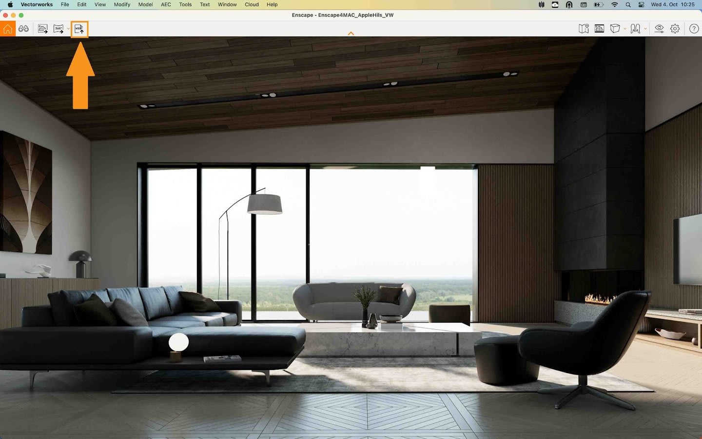

To start Enscape with any given project open, click the Enscape icon towards the top of the toolbar in Vectorworks. If you’re not in a 3D view, you might see a message asking you to select a 3D view to start Enscape. In that case, just select “Normal Perspective” in the Viewport settings to get going.
After starting Enscape, a separate window opens to show an accurate representation of your design. To move around and explore your project, you can either use the WASD or the arrow keys.

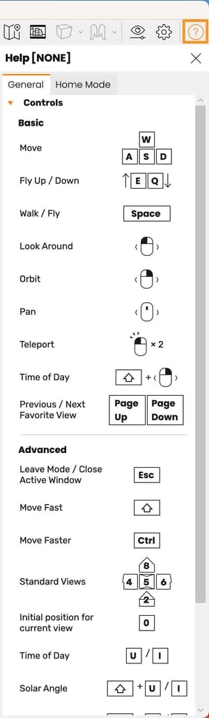

To access the help menu which displays all of these controls and many more, click the question mark icon in the top right corner of the Enscape window.

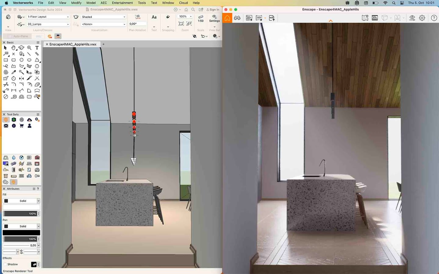

As Enscape is a plugin that’s integrated directly into Vectorworks, it’s always possible to visualize your rendered project in real time.
With the help of two features, Synchronized Views and Saved Views, you can quickly view your project as you design and prepare presentations.
By enabling Synchronize Views, as you navigate Vectorworks, Enscape will follow and show you the same view. This is ideal for quickly seeing how changes to the model will look and affect a project in reality.
With any Saved Views that you have set up in Vectorworks, these can also be visualized immediately in Enscape, which is particularly handy for when you need to present your ideas.

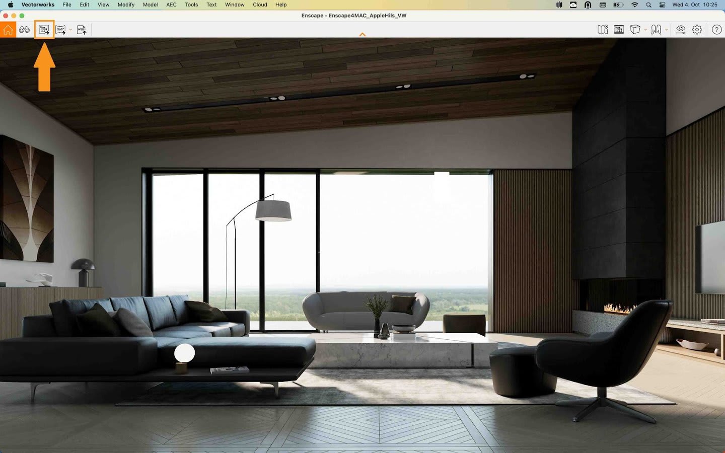

In the Enscape window, click the button with the binocular icon in the toolbar at the top. This opens up Enscape View Management. Clicking any of these views will move the Enscape camera to the correct position and even update the time of day and visibility settings based on what has been set for that particular saved view. This helps to significantly speed up the amount of time it takes to prepare a presentation.

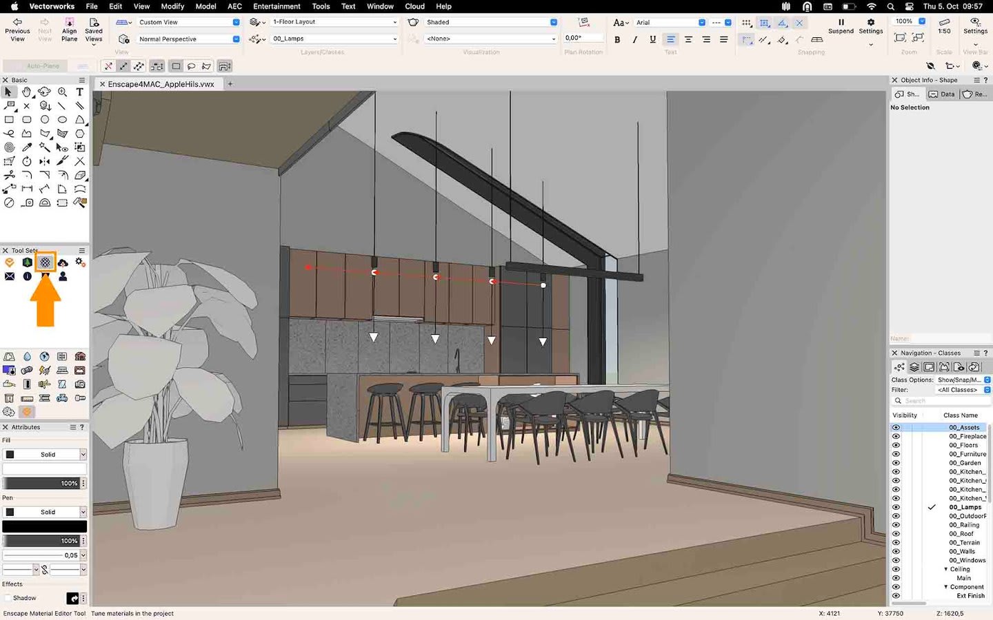

Below the Asset Library button in the Enscape Tool Set is where you can find the Enscape Material Editor. This is one of the most important parts of the user interface.
This is where you can edit and enhance your existing Vectorworks materials (or textures, as they are referred to in Vectorworks) for improved realism.
If you want to create a new texture and apply it to a part of your design, you still do that in Vectorworks. Having the Enscape Material Editor open, you will find a list of all of the textures in Vectorworks. They will appear as materials in the Enscape Material Editor, and changing anything about them in one tool will also change it in the other.

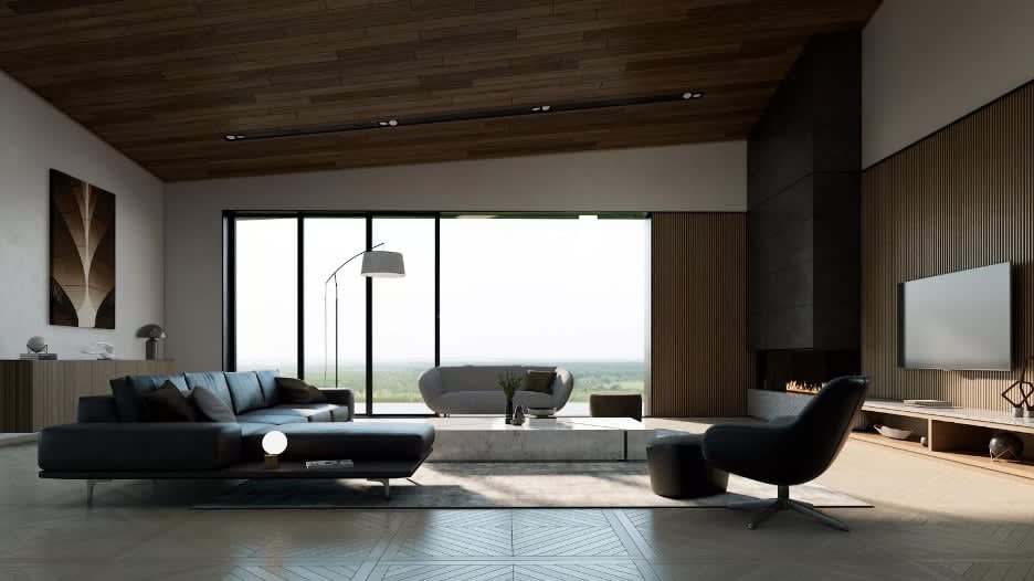

You may also wish to change the time of day (shift + right mouse button), and enable Safe Frame, so you can see exactly which parts of your scene will be rendered. When ready, click the Screenshot button which is located on the Enscape toolbar at the top left of the rendering window. Your image will be created in just a few seconds.
