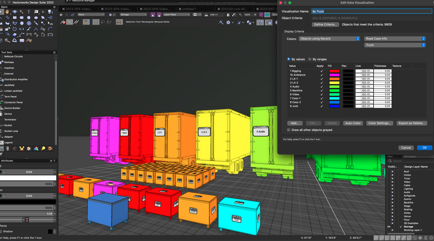

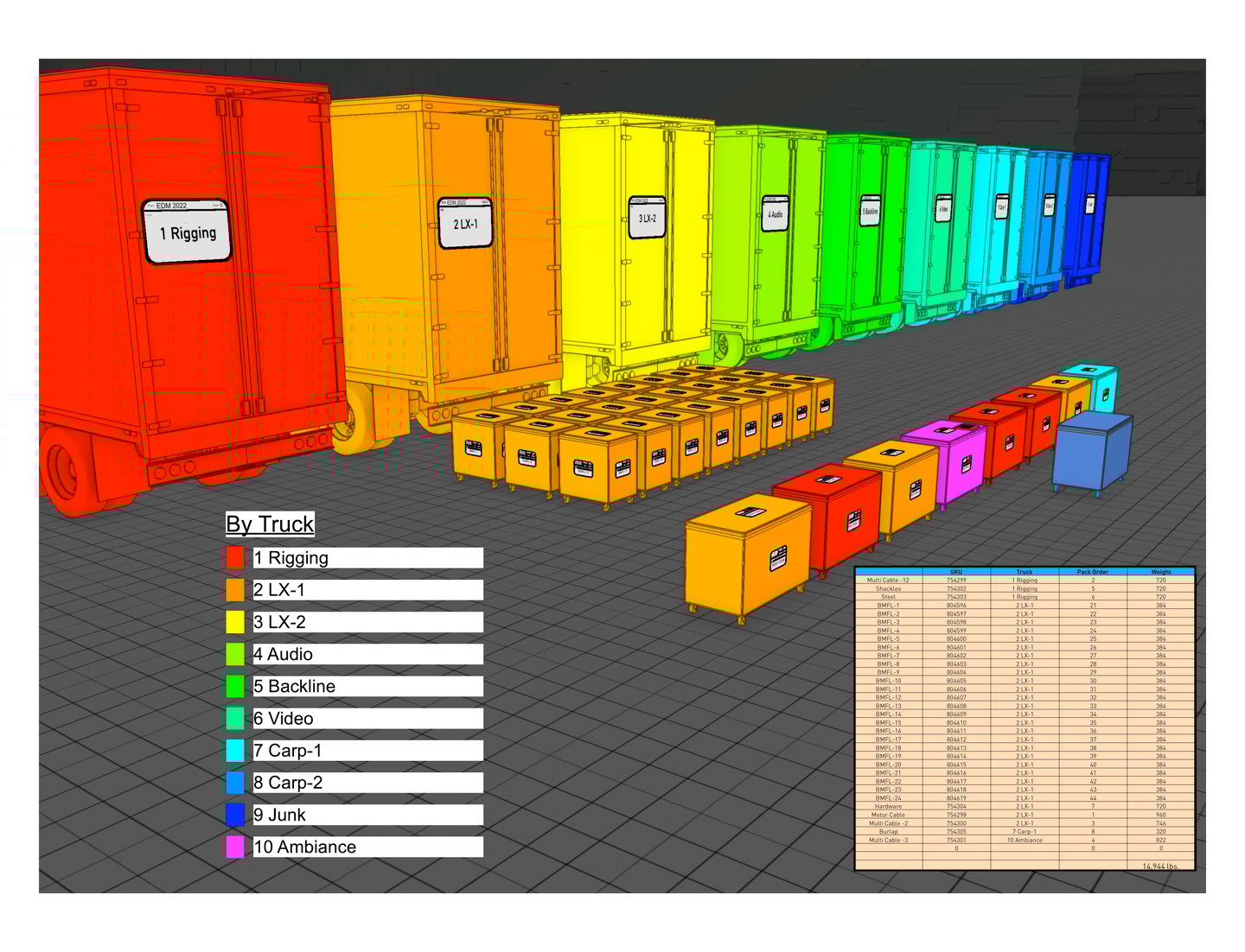

(***BONUS TIP: Data visualization in Vectorworks Spotlight is a great way to illustrate vital information without having to redraw or reset an object’s attributes. For the supplemental lighting package example, you can use data visualization for truck pack order.

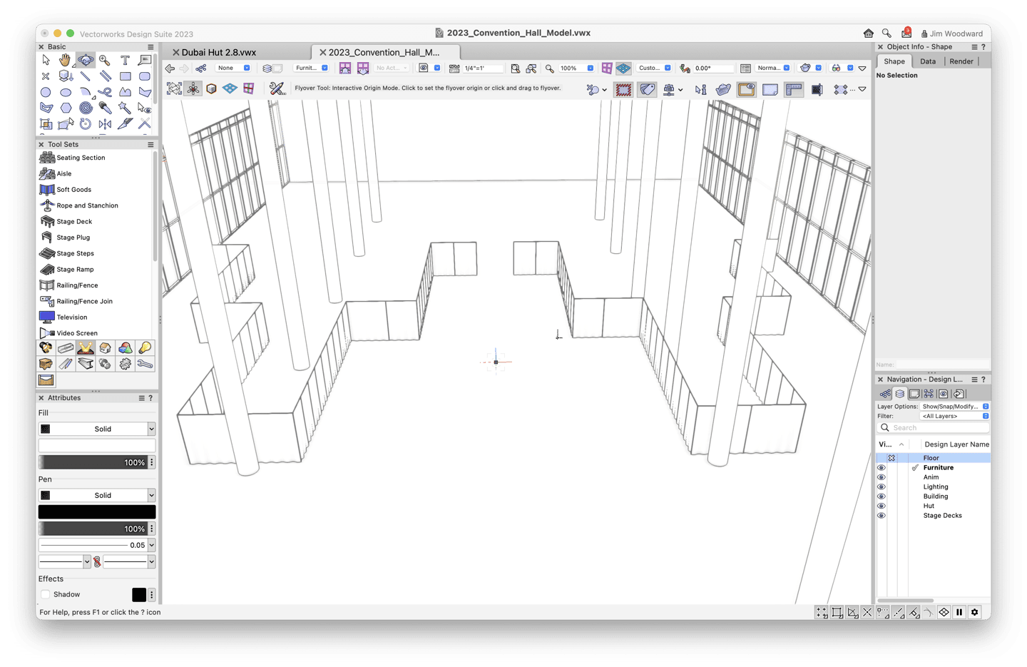

While referencing in Spotlight is about your drawing or modeling elements, it, in fact, saves you from having to repeat creating the elements or editing them to fit a new venue. This is nice because, let’s face it, recreating elements from scratch can be a waste of time.
Referencing allows you to use drawing elements from another file in the active file, which — if you’re working on a tour — can ensure consistency as you move from city to city.
Referenced Model Partitions 2
For example, if a venue changes an air-wall configuration or seating layout, your file that’s referenced to theirs will alert you to said changes.
When a referenced item in your main file changes, the changes are reflected in the new,“target” file.
