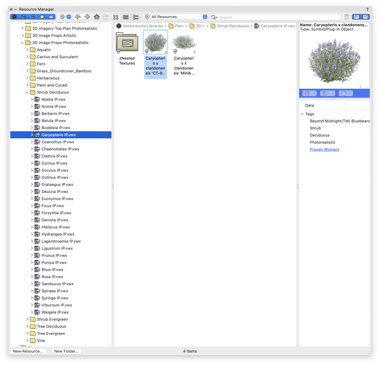

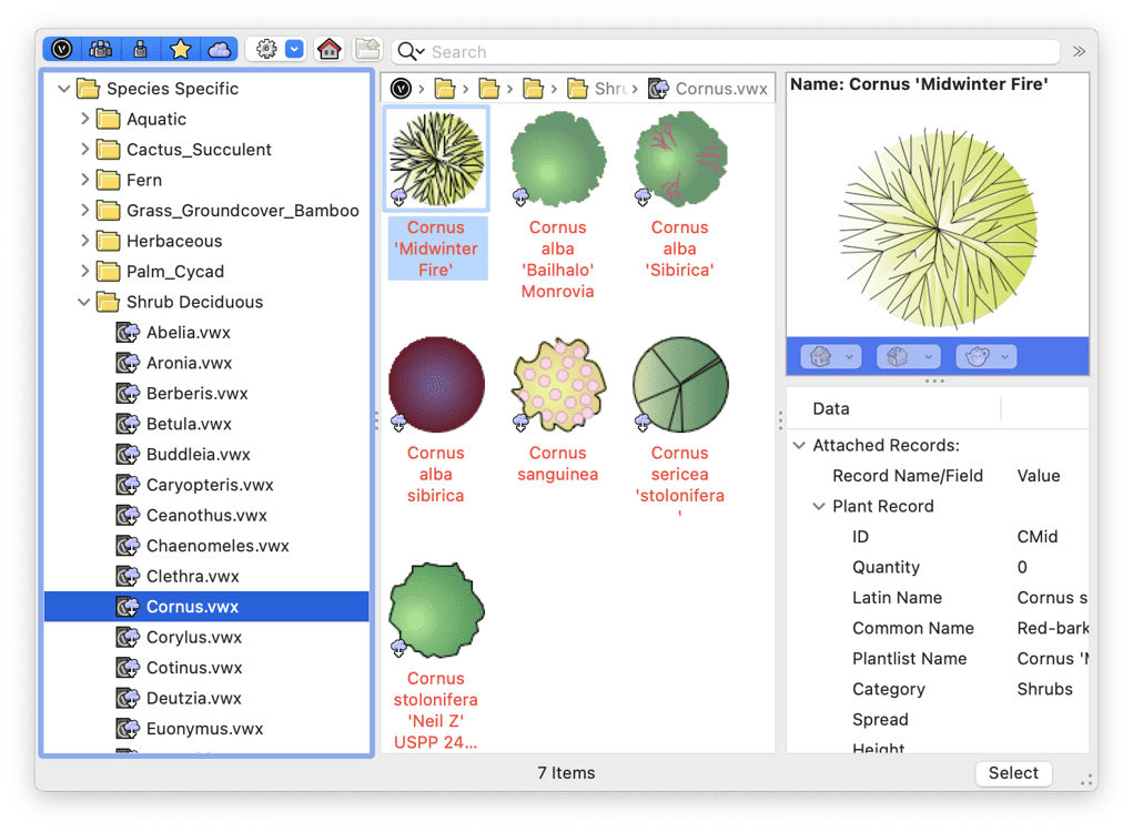

Preconfigured plant styles are found within the Resource Manager and via the Plant tool’s Resource Selector. These styles may already have a 3D representation with pre-identified styles and attached image props.
Of note, we’ve recently added a new library with 3D modeled plants, thanks to Proven Winners and ColorChoice.
Non-species-specific styles may have place-holding 3D graphic image props, which you can easily replace later in the process for more specificity. The Edit 3D Graphics option in plant style settings allows replacing a plant style's 3D representation.

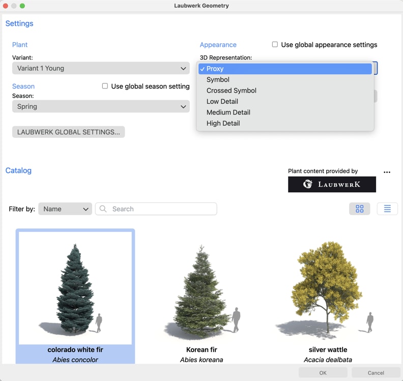

In a plant style's graphic settings, the recommended options include Laubwerk geometry and image props.
With Laubwerk’s libraries, which were recently added thanks to our partnership with Laubwerk, there are 145 plant species-specific options, with variations for age and instance and global settings for season and 3D representations. For BIM file exchanges in IFC or RVT formats, Proxy and Symbol are recommended.
Laubwerk objects can also be placed outside of plant styles in the Visualization toolset, with the same settings.
Image props can be used from the 3D Image Props folders in the Resource Manager or created as new resources.
Creating image props as new resources allows you to save your work and reuse it on future projects. You can find the Create Image Prop command in the Model drop-down menu. After clicking the command, you can edit the 3D graphics. Be sure to place the image prop in edit mode at 0,0.
