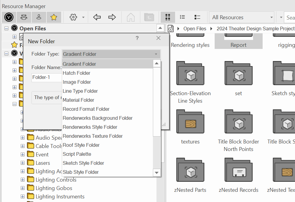

Next is the organizational and naming structure of your libraries. Always use resource folders; these will be visible in the Resource Manager and make the library more manageable.

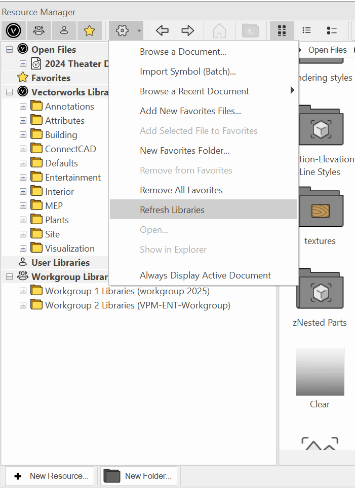

Your primary tool for accessing your libraries is the aforementioned Resource Manager, which you can access with the Ctrl-R shortcut. The Resource Manager gives you an overview of all your available resources, including those in your active file, our default libraries, Open Files, Favorite Files, User Files, and Workgroup Folders.
Remember that only your active and favorite files will be checked for changes whenever you open the Resource Manager. Use the Refresh Libraries command to update the manager whenever you change your user or Workgroup Folder libraries.
refresh libraries vectorworks resource manager
If you find that libraries are missing, for example, from the normal Vectorworks defaults, try deleting the Resource Manager cache found in your User Folder. This will force Vectorworks Spotlight to create a new cache and make any missing libraries available again.

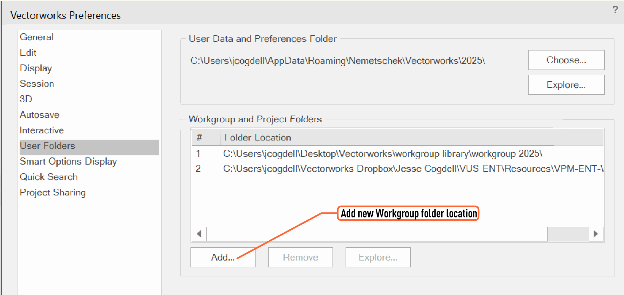

Workgroup Folders: Workgroup Folders function like User Folders but allow you to choose their location, enabling easy sharing via a network drive or cloud storage, such as Vectorworks Cloud Services. These files require manual setup, as Vectorworks Spotlight needs to be directed to their location.
