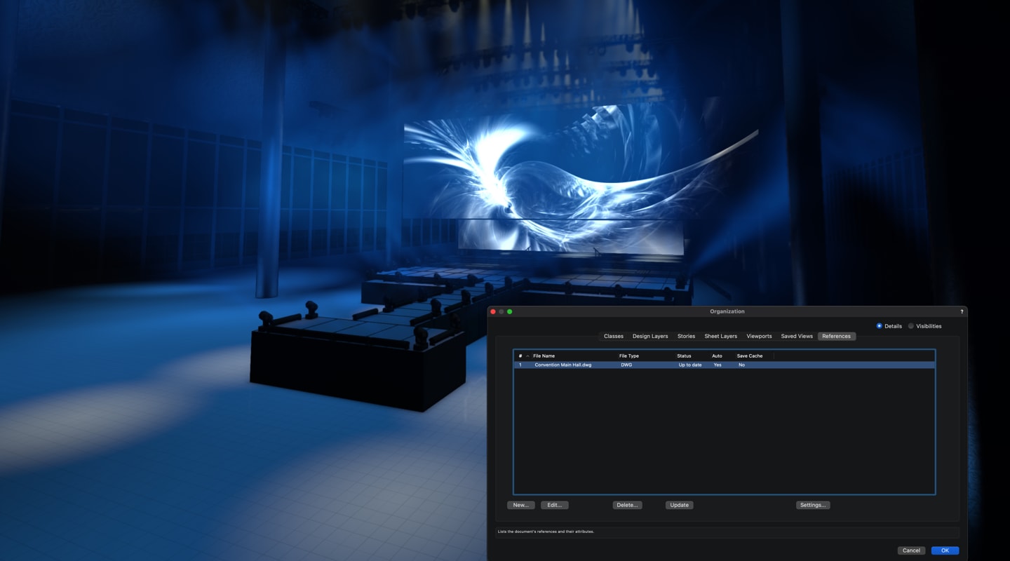

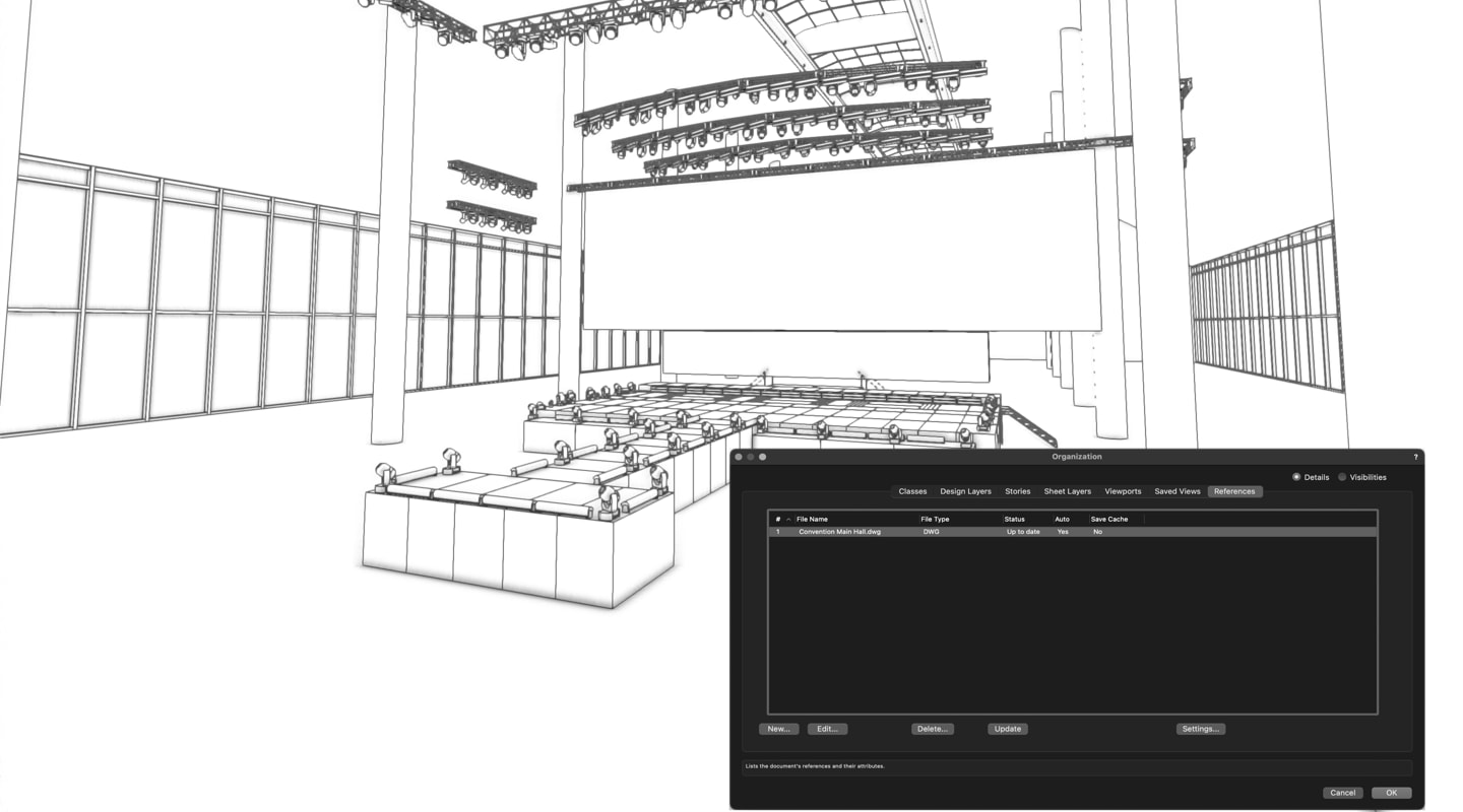

This file will be the framework of your project, as importing a DWG file and using it as a reference for your design, in a sense, creates the lines that you get to color within. Once your design is finished, you can then disconnect the referenced DWG file, optimizing the speed of your remaining Vectorworks file.

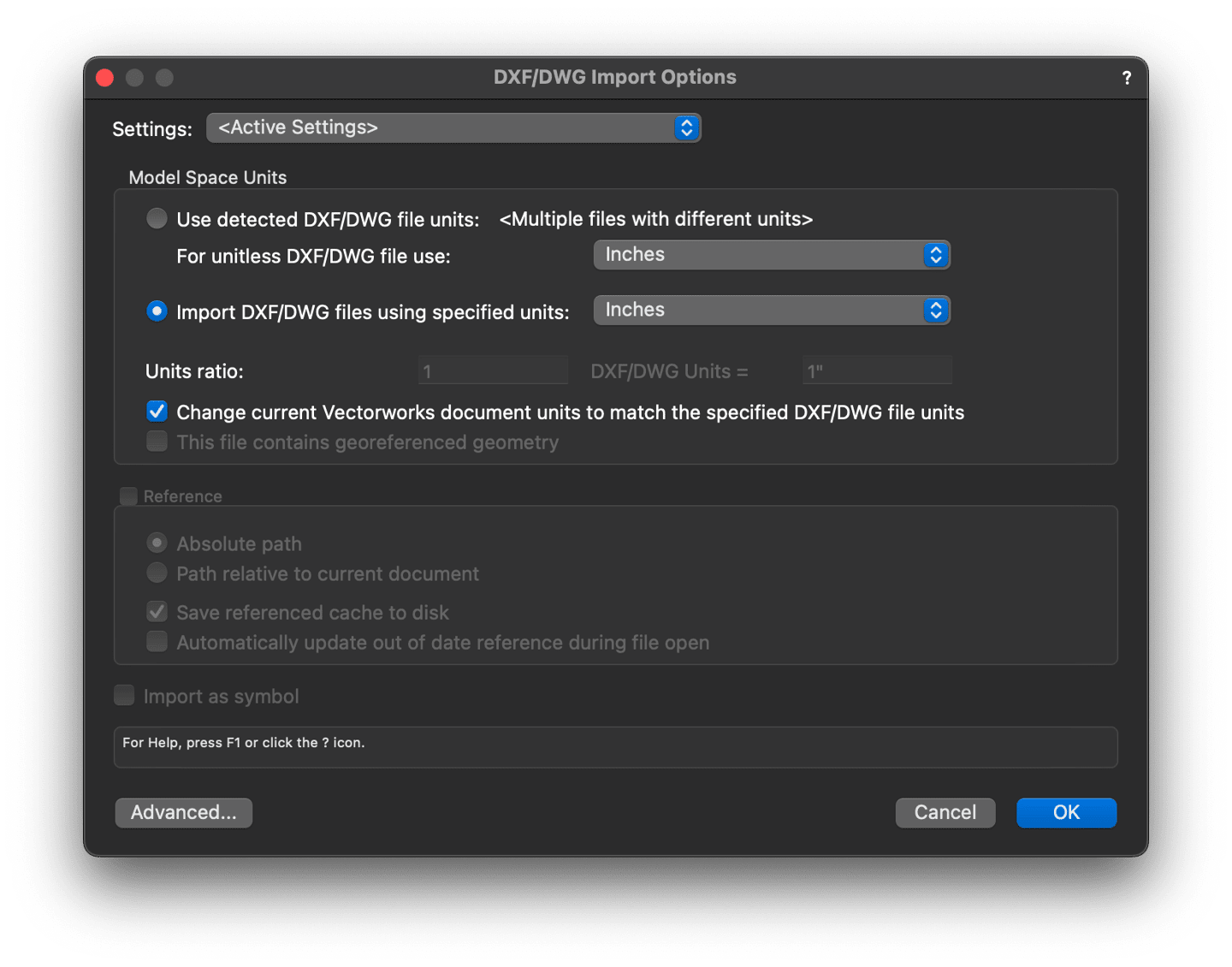

There are a couple ways in which you can import your venue's DWG file into Vectorworks. Import Single DXF/DWG and Import DXF/DWG or DWF both import external files into your internal file. The only difference between the two commands is the number of file references that’re brought in or associated.
DWG Import
Additionally, Vectorworks displays an alert if any external reference files are missing upon import, ensuring that no vital information goes missing without you noticing.

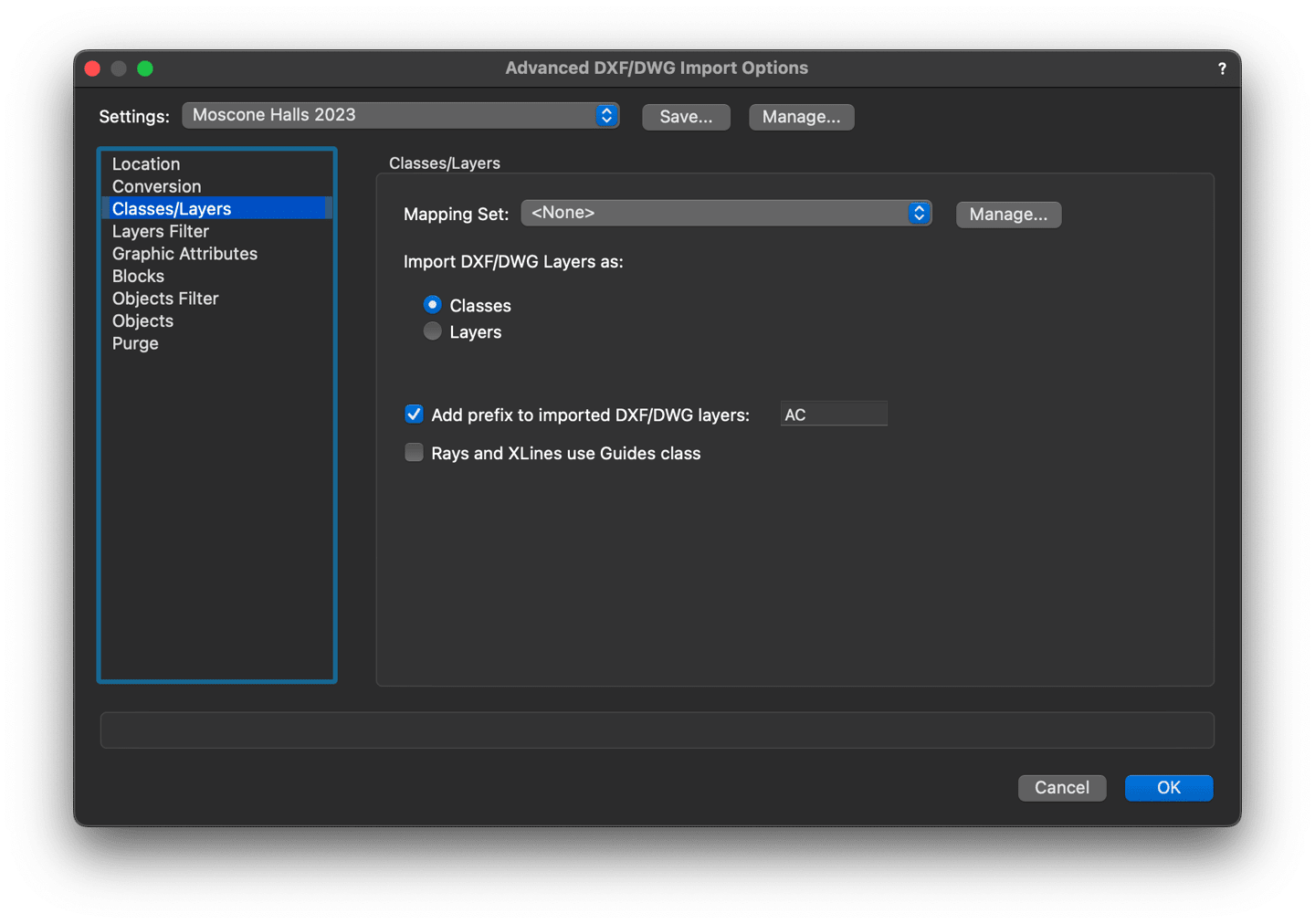

It's also important to remember that, once exported, Vectorworks classes become layers, and optionally, our layers become separate files so that you do not have to spend extra time confirming the location of certain information with your collaborators, such as decorative architecture or HVAC specifications.

There are also advanced settings for imports and exports that you can save as presets. This way, your import/export process is sped up when working with different clients, vendors, and venues.
