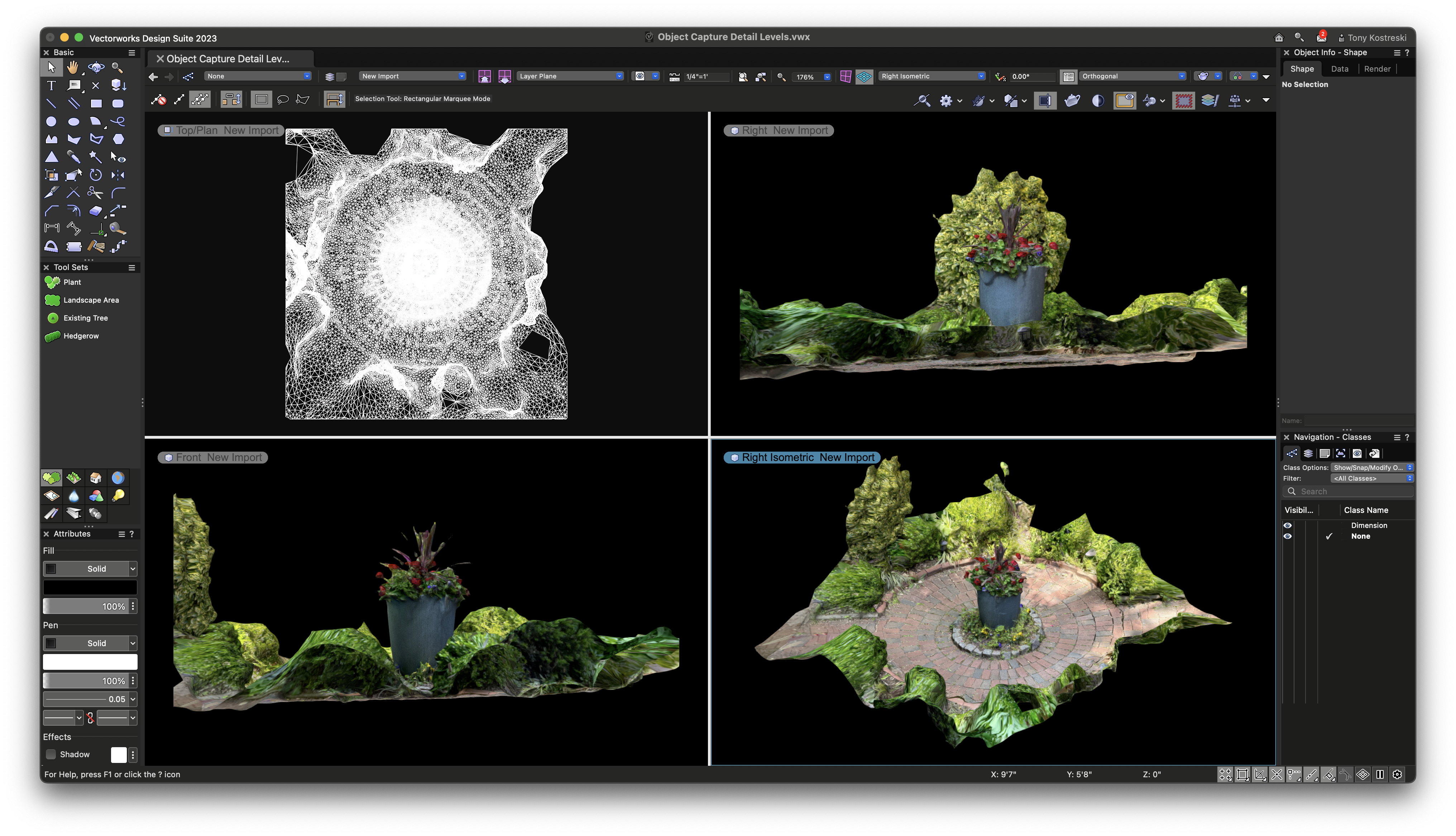

After you’ve finished capturing site conditions with your mobile device, the Nomad app produces an OBJ and USDZ file, both of which can imported into Vectorworks. When you import either file, you’ll see a 3D mesh. Enabling multiview then lets you see the object from different perspectives.

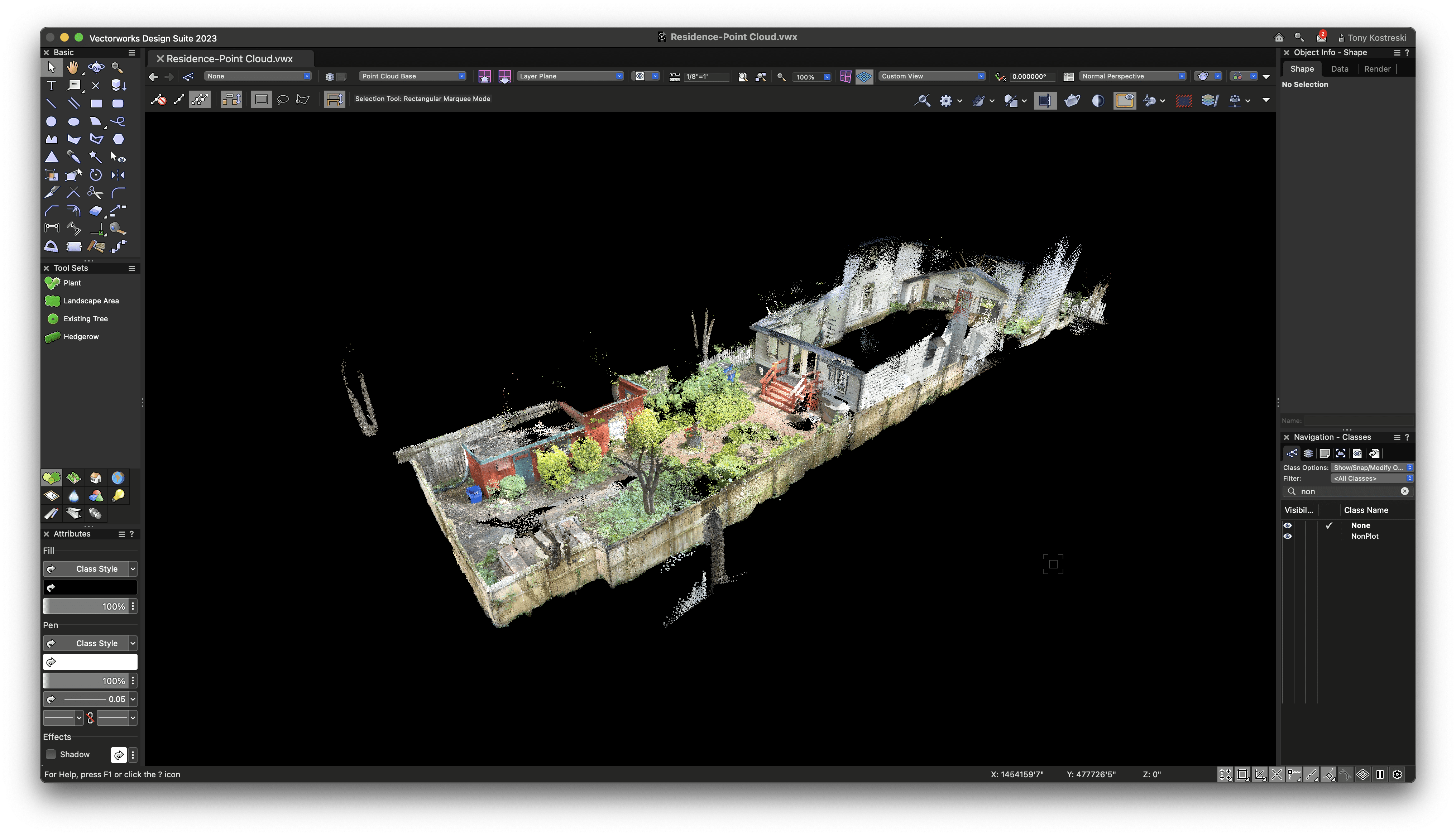

For point-cloud scanning, the Nomad app will produce a PTS file that can be imported directly into Vectorworks at scale. This point-cloud representation can then be traced over, so you have a base of existing conditions to work from for your site design.

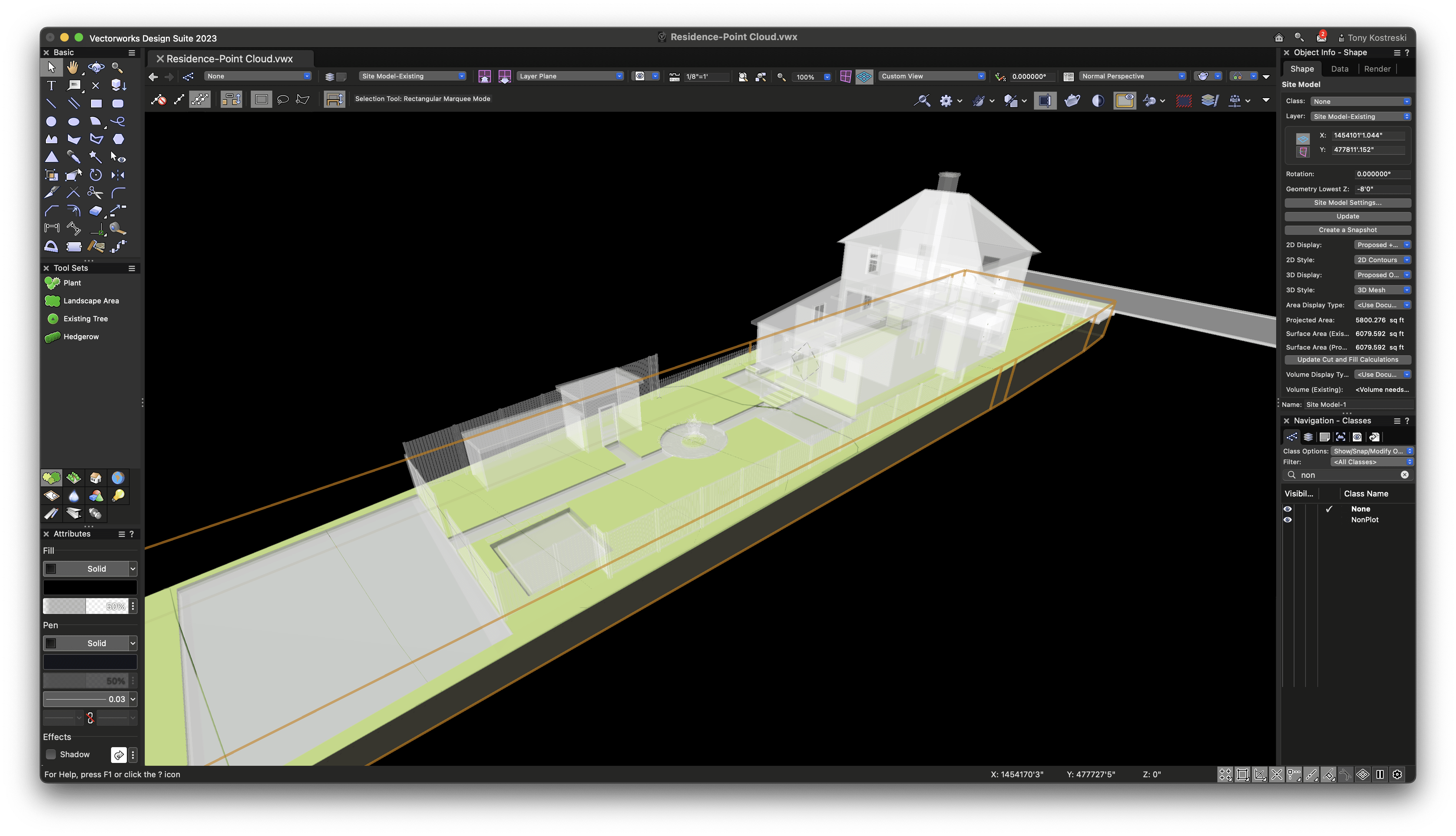

The 3D points from the point-cloud scan can also be used to generate a site model. Stake Objects can be easily placed throughout the Point Cloud by snapping to specific points, allowing you to take advantage of the Create Site Model from Source Data command. This can’t replace the complete accuracy of a regular survey, but it does give you a fantastic starting point for your conceptual design process.
