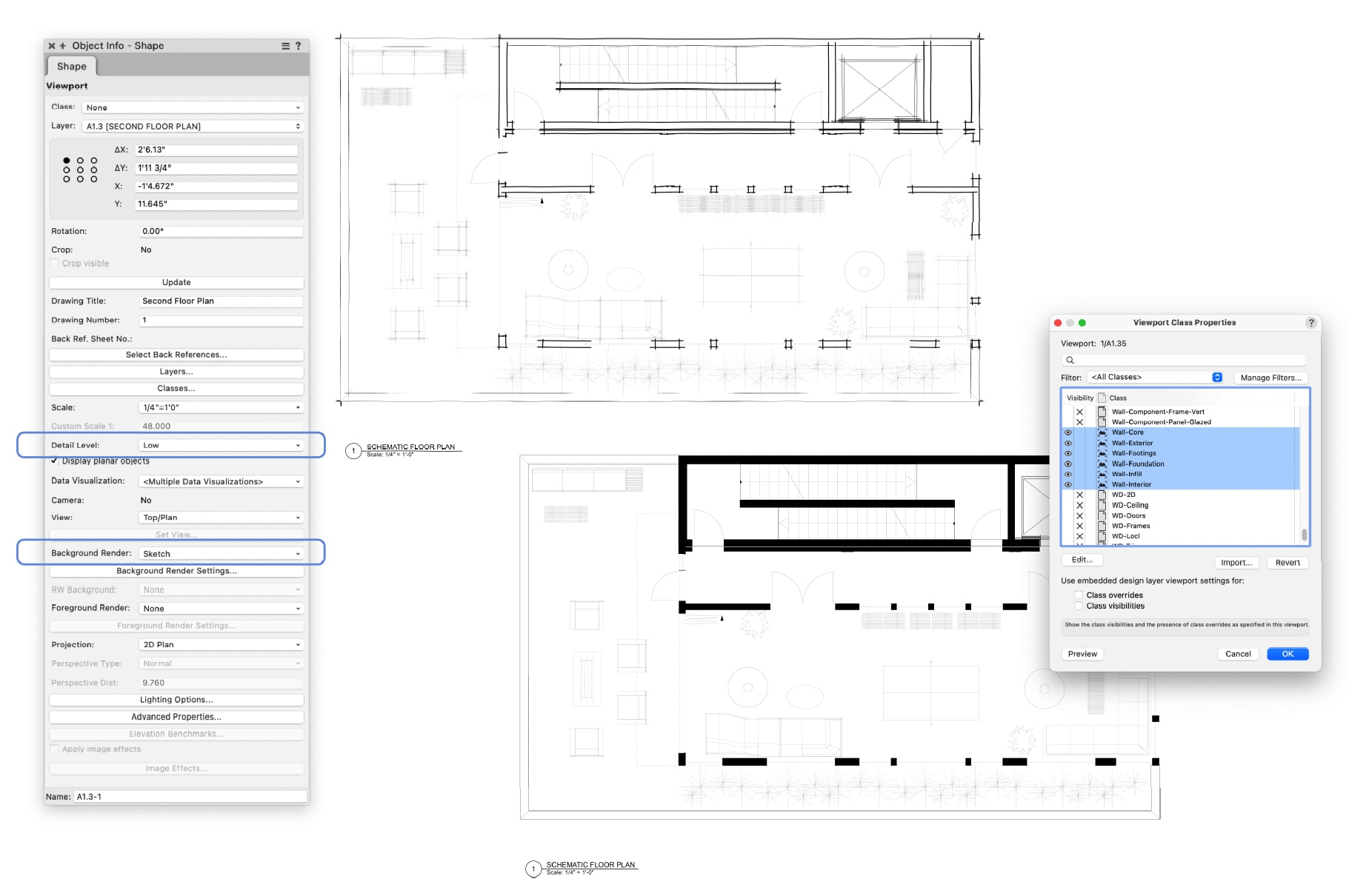

Conceptual and Schematic Drawings
To start, let's dive into the conceptual and schematic stage of drawings. By applying a sketch style in the viewport settings, you can create a more artistic and expressive representation.
Using class overrides allows us to achieve a unique poché style for wall fills. This technique not only adds depth to the drawing but also creates a visually striking effect.

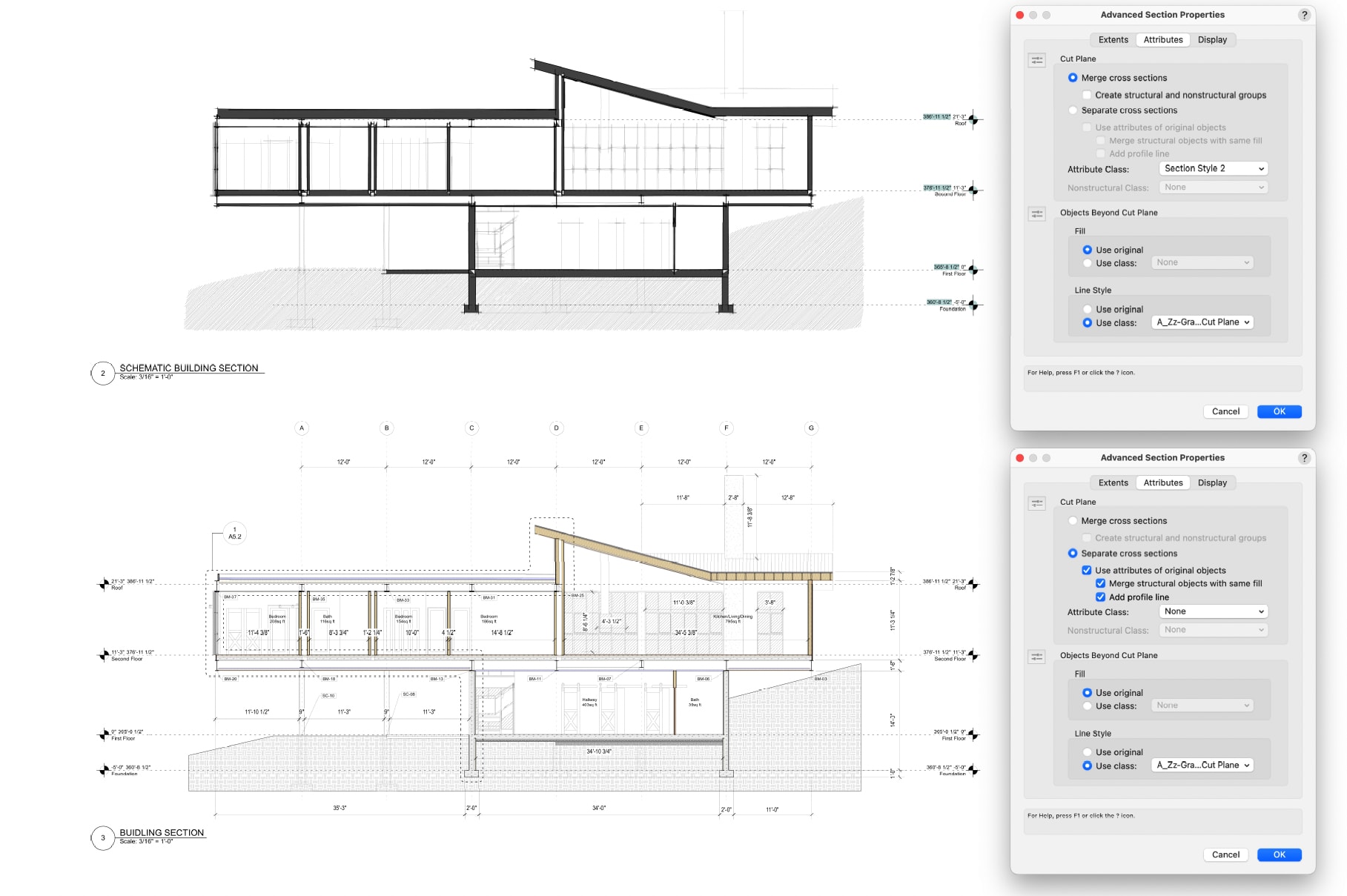

Design Development & Construction Documentation Drawings
Moving on to the design development and construction documentation plans, it’s crucial to showcase the wall components accurately. By adjusting the class visibilities and setting up viewport settings properly, you can get a nearly perfect building section just from your BIM model.
