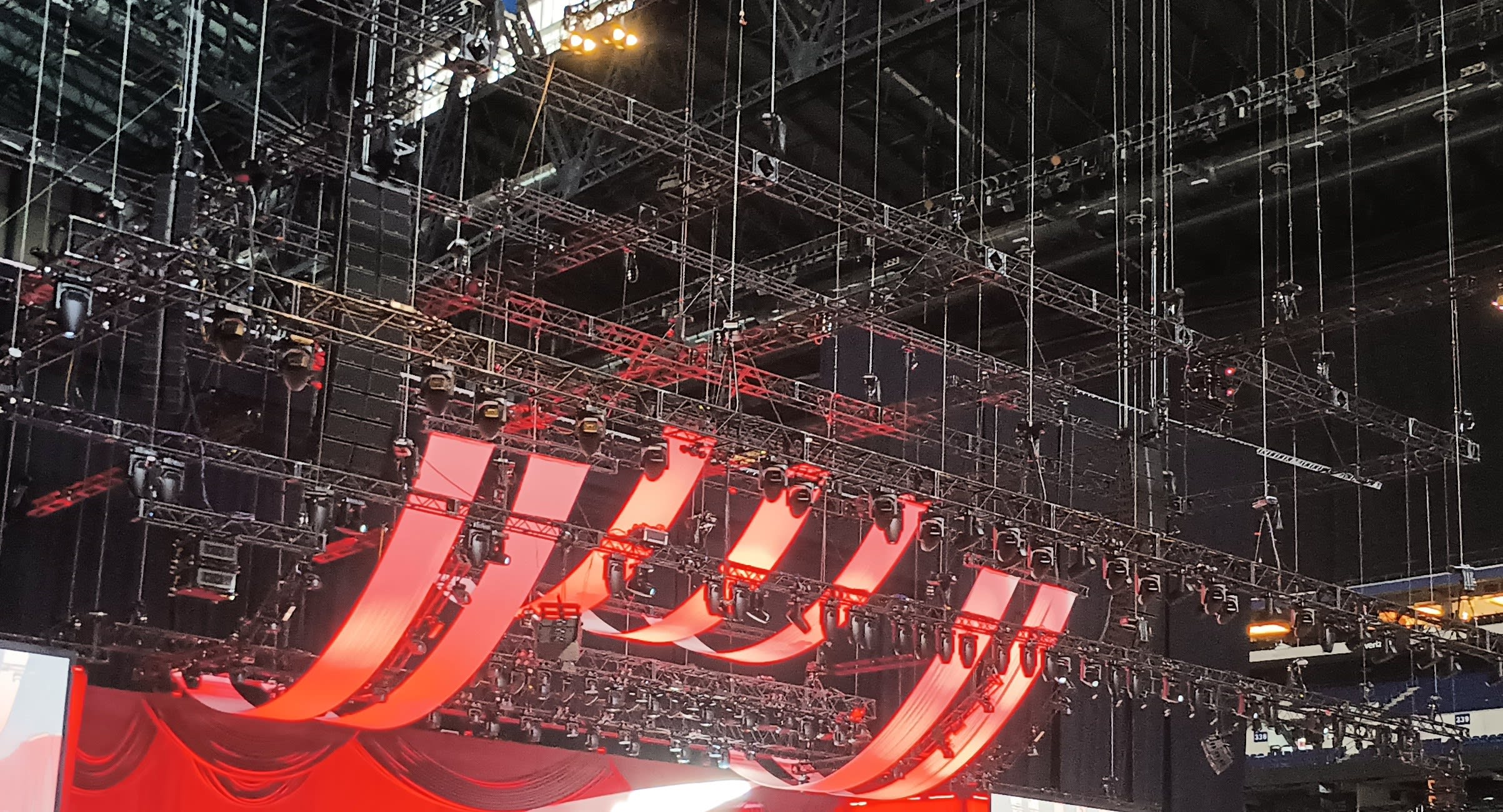

event rigging design
Image courtesy of Ben Elmore, Freeman Company.
Event rigging encompasses all forms of temporary rigging systems used across a wide range of venues and event types, including concerts, tours, exhibitions, trade shows, and arena events. Unlike theatrical rigging, event rigging doesn’t rely on permanent structures. Instead, you’ll need to assess the building's structural capacity (e.g., roof beams or gridiron) and design a custom rigging plan that supports the needs of each specific production.
Event rigging also involves the suspension of trusses, lighting arrays, LED walls, audio systems, and scenic elements, frequently above large crowds. Whether in a stadium, convention center, ballroom, or outdoor setting, event rigging is all about adapting to ever-changing locations and show requirements.

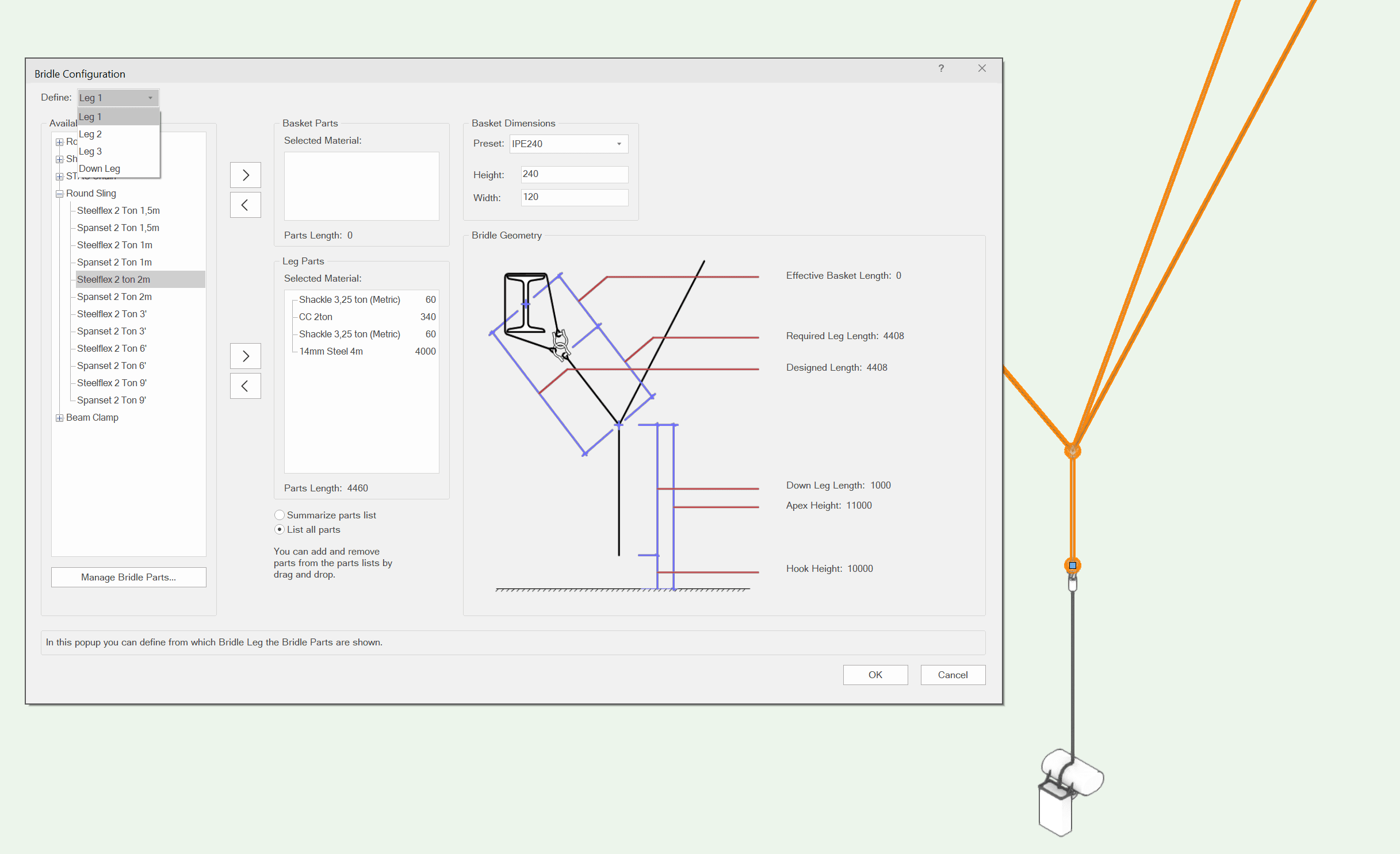

bridle tool Vectorworks Spotlight
Modern rigging relies heavily on specialized software to plan, model, and analyze rigging systems. Vectorworks Spotlight’s Bridle tool is a great place to start; and to dive deeper into the feature and its capabilities, click here.

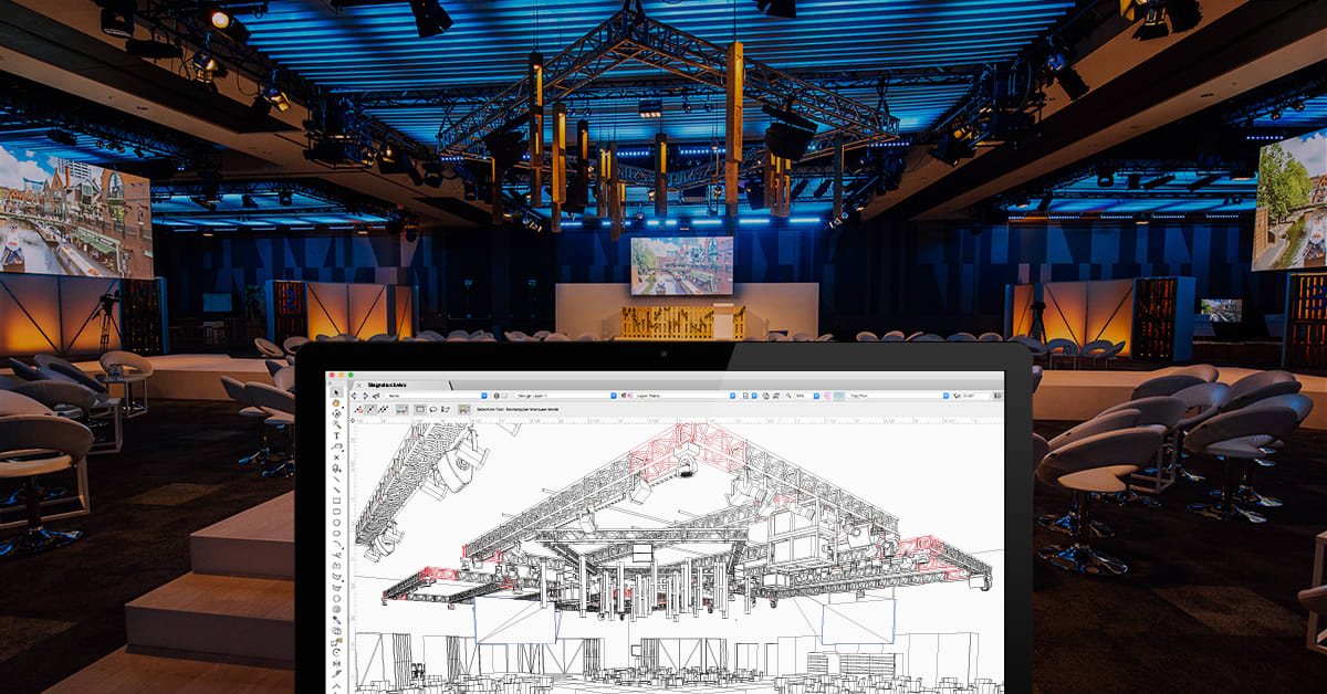

As previously mentioned, Braceworks, Vectorworks’ entertainment rigging add-on, offers an even more comprehensive approach to rigging design and analysis.
Braceworks allows you to model entire rigging systems in 3D, including trusses, hoists, and loads. You can also perform detailed load calculations to verify that every rigging point, truss, and hoist can safely support the intended loads.
Furthermore, you can simulate real-world forces, helping spot potential issues before anything is installed, and generate detailed reports and documentation for production teams and venue operators.
Ultimately, Braceworks helps you optimize your designs for safety and efficiency through the automation of complex calculations and visual feedback.
