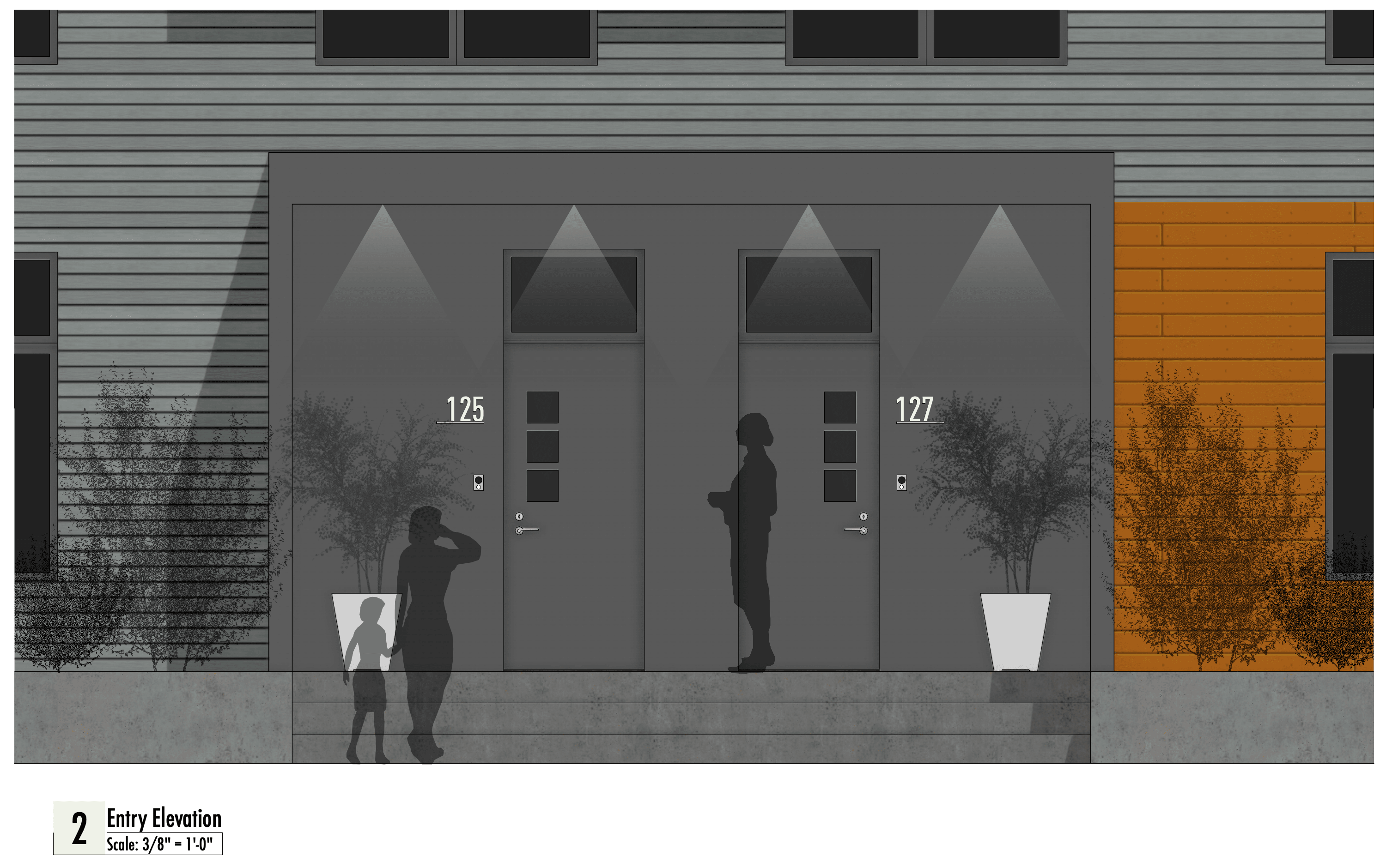

These show the outside of a building — features like facades, materials, window placement, and door types.

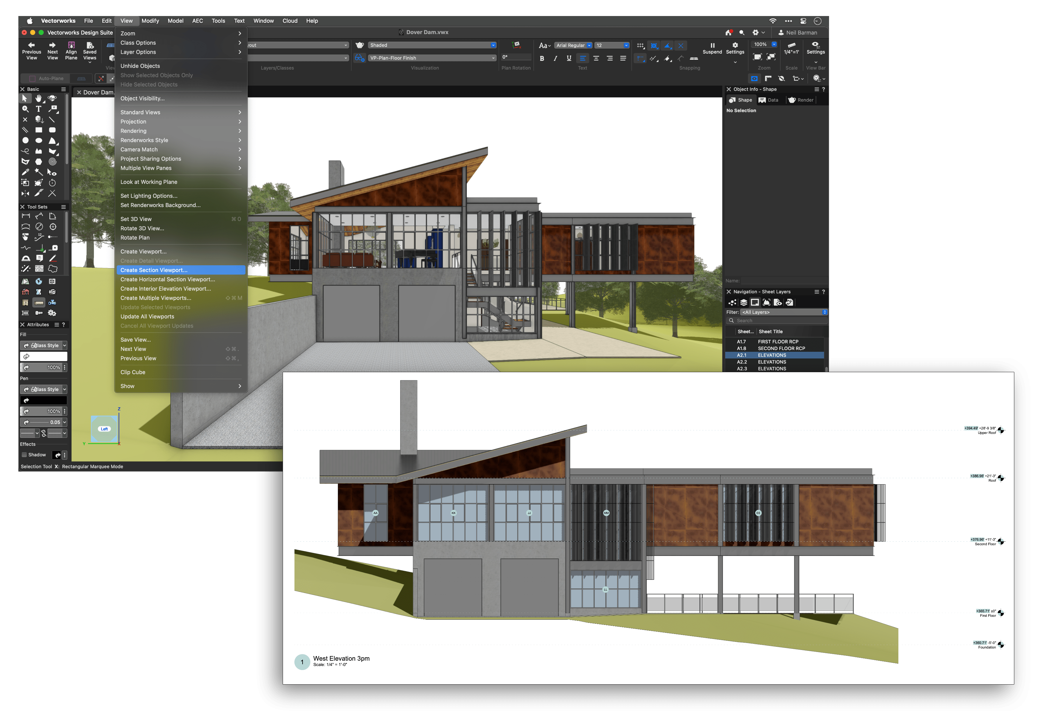

In Vectorworks, you can create elevations quickly by generating viewports from your model. Go to the View menu and select Create Viewport to choose orthogonal views (Front, Back, Left, or Right) that are ideal for exterior elevations or simple views. For more detailed drawings, you can use the Create Section Viewport command, which works well for exterior elevations, section-elevations, or partial interior elevations.
For full-room interior elevations, try the Create Interior Elevation Viewport command. It automates the generation of four elevations (North, East, South, and West) based on the room's geometry. Both Section Viewports and Interior Elevation Viewports come with smart markers, which help automate drawing coordination and give you more control over graphic attributes. That extra control is key to creating clear, professional documentation.
Elevations can be set to be shown as simple hidden lines, rendered surfaces, or even colored and textured presentations, depending on your needs.
