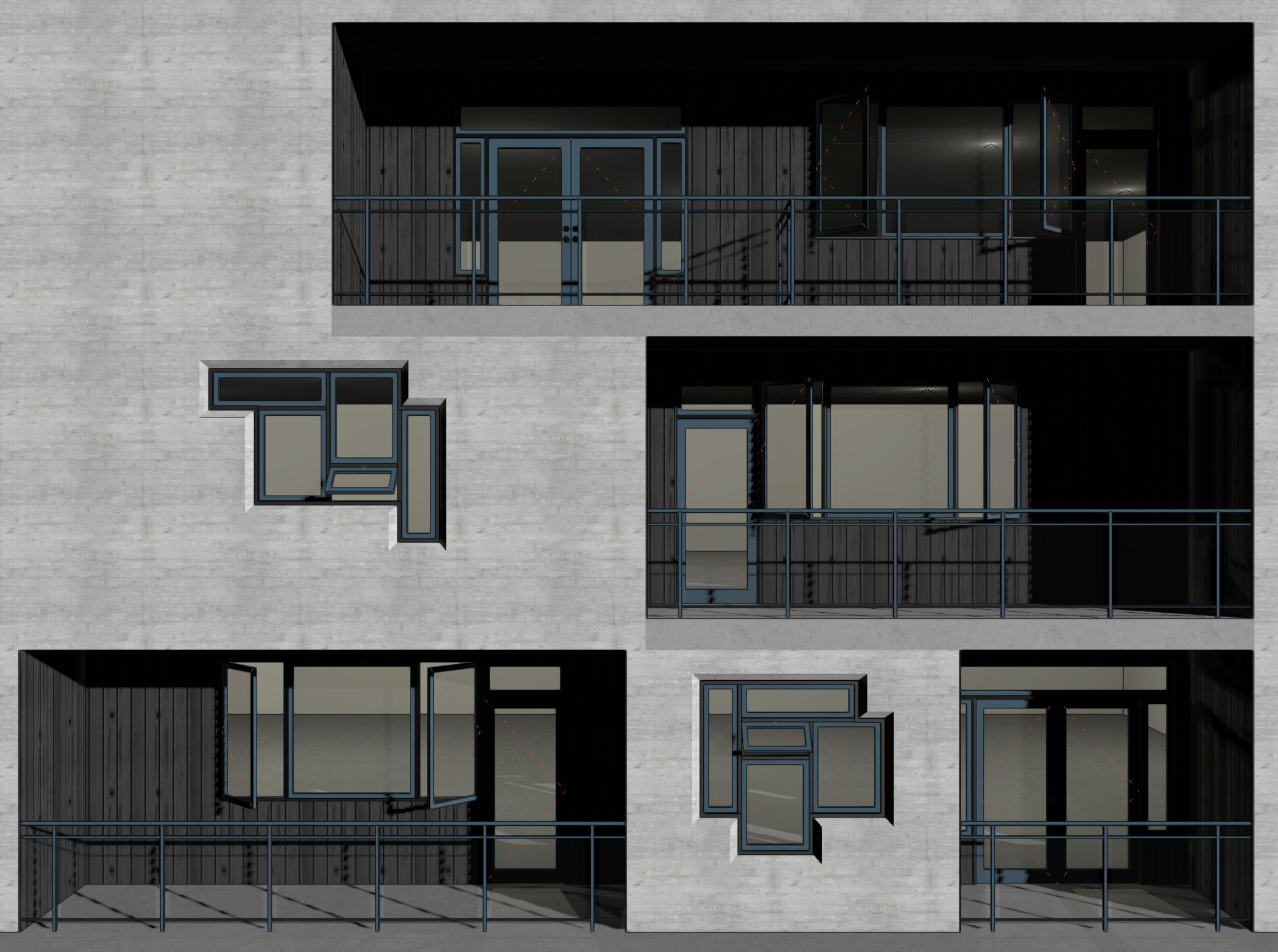

You can also place a prebuilt assembly style directly into a Wall or create a custom shape by drawing a 2D object on a Wall and converting it. That last option is especially useful when you’re working with non-rectangular or highly custom designs.

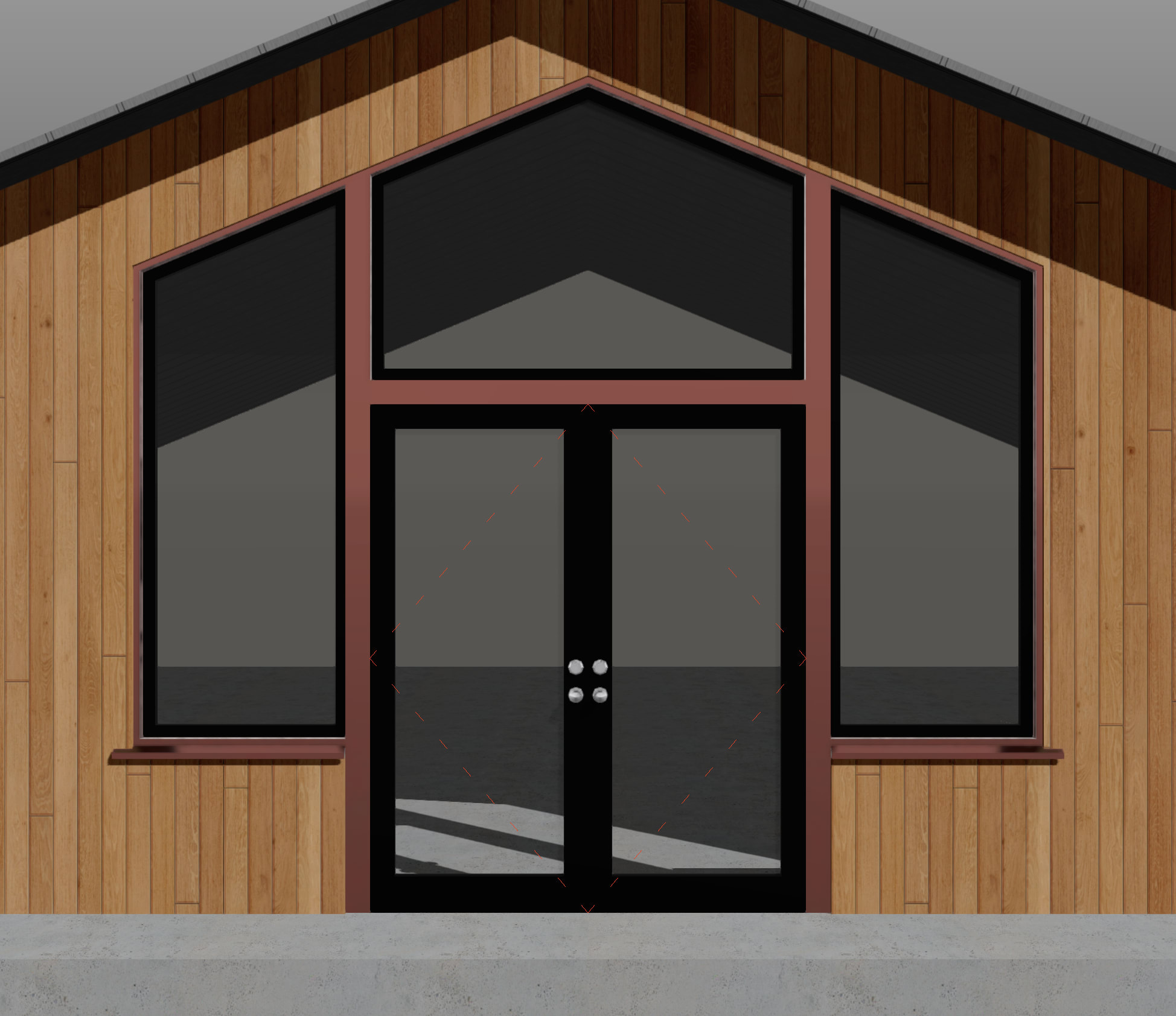

Frames and mullions are at the core of how an assembly is built.
You can choose to keep the original frames of each Door and Window, which is useful for mulled or ganged configurations installed on site. Or you can create a single outer frame that replaces the individual ones, which is more typical for storefront systems. Mullions then take over the role of dividing the units inside that frame. Their placement, depth, and alignment can all be controlled, and you can fine-tune them later if needed.

Reshaping the overall assembly is also flexible. You can scale it by dragging control points, which adjusts everything proportionally, or you can reshape specific edges and vertices for more localized changes. If certain units need to stay fixed, you can lock their dimensions so that they don’t stretch along with the rest of the system.

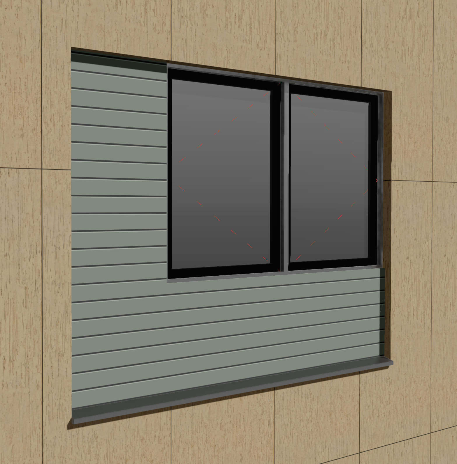

In practice, assemblies behave as a single object when placed in a wall. Wall closures apply to the entire unit, while individual components still retain some control, like offsetting a door to the interior face while keeping Windows aligned to the exterior.
