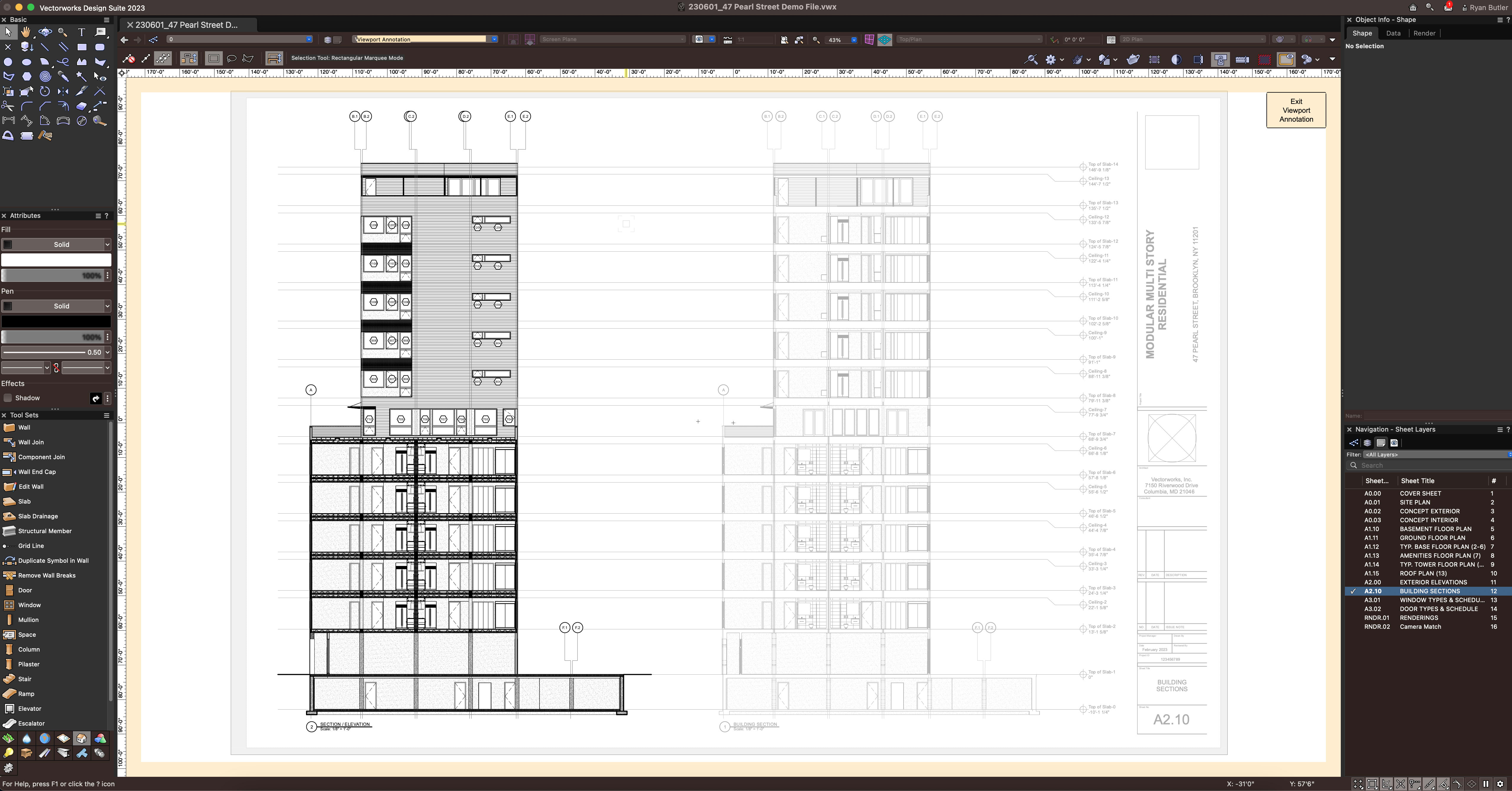

One of the main methods is to use viewports, which enable you to create plans, elevations, sections, interior elevations, and details without having to redraw the entire building.
To create an elevation view, for example, you can go to the View menu and select Create Viewport. From there, you can choose an orthogonal view with hidden line rendering to create an accurate and detailed view. It’s that easy.

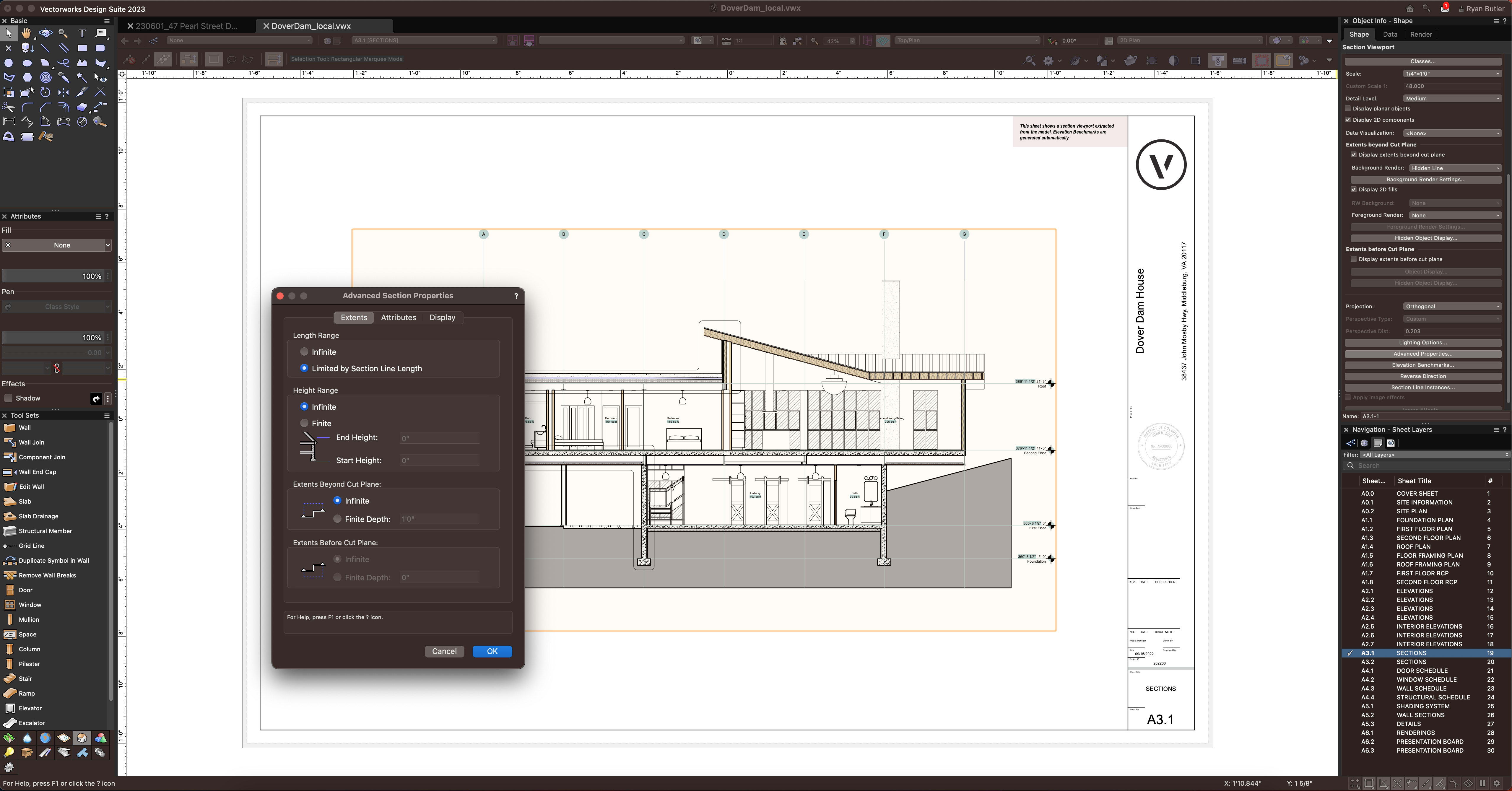

When it comes to section viewports, go to the View menu and select Create Section Viewport, followed by drawing the section line. This method offers section style settings, which allow you to decide whether to show the components within the section cavity or merge them together with a fill or hatch, based on classes. Additionally, the cut plane graphic attributes and the graphics beyond can be edited via class attributes.

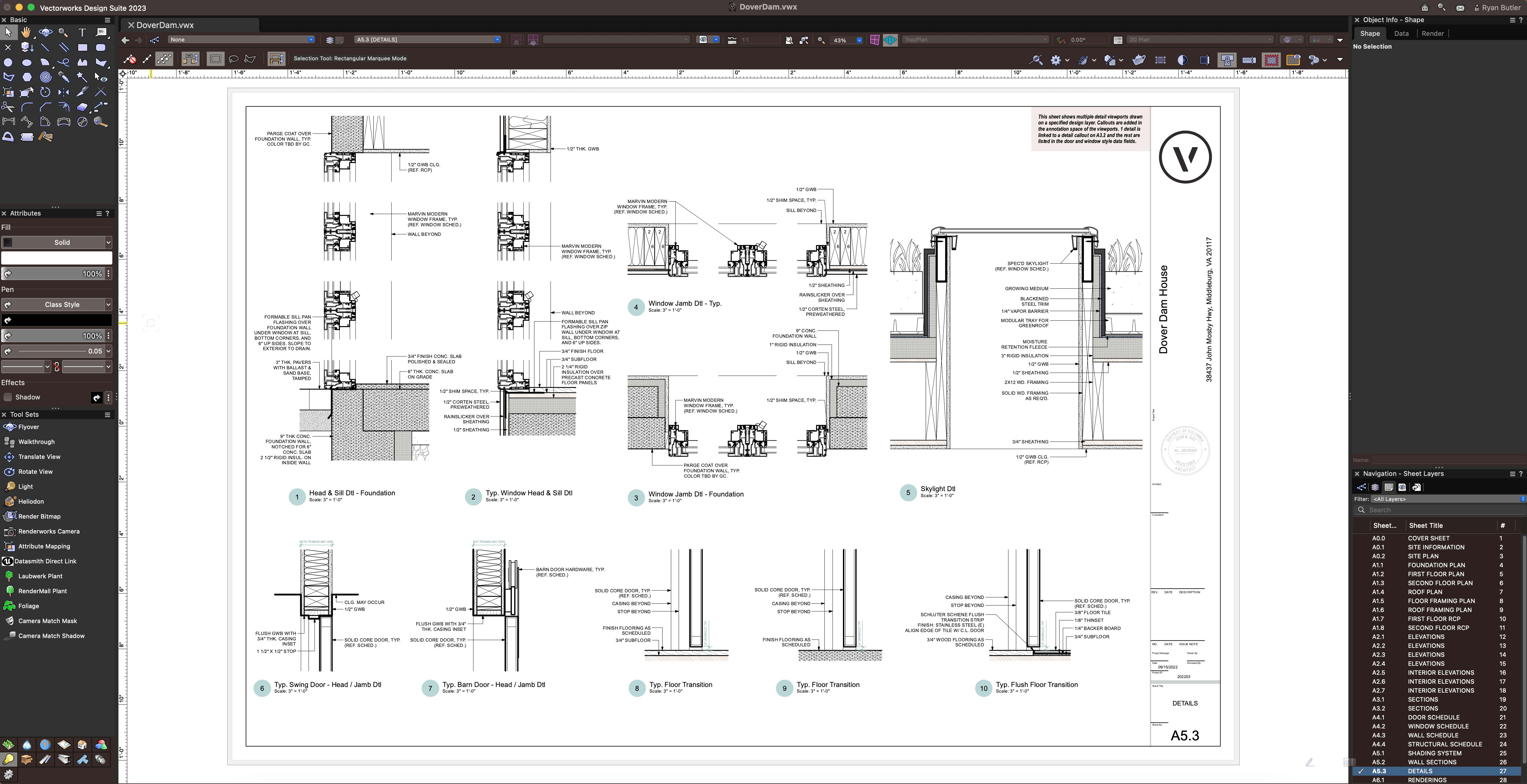

Detail Sheet
Moreover, a great bonus when exporting drawing sets to PDF is that smart markers will retain their hyperlink behaviors allowing easy navigation for everyone collaborating on the project.
All of these tools and techniques make the process of creating detailed drawings much more efficient and effective, helping to streamline the documentation process.

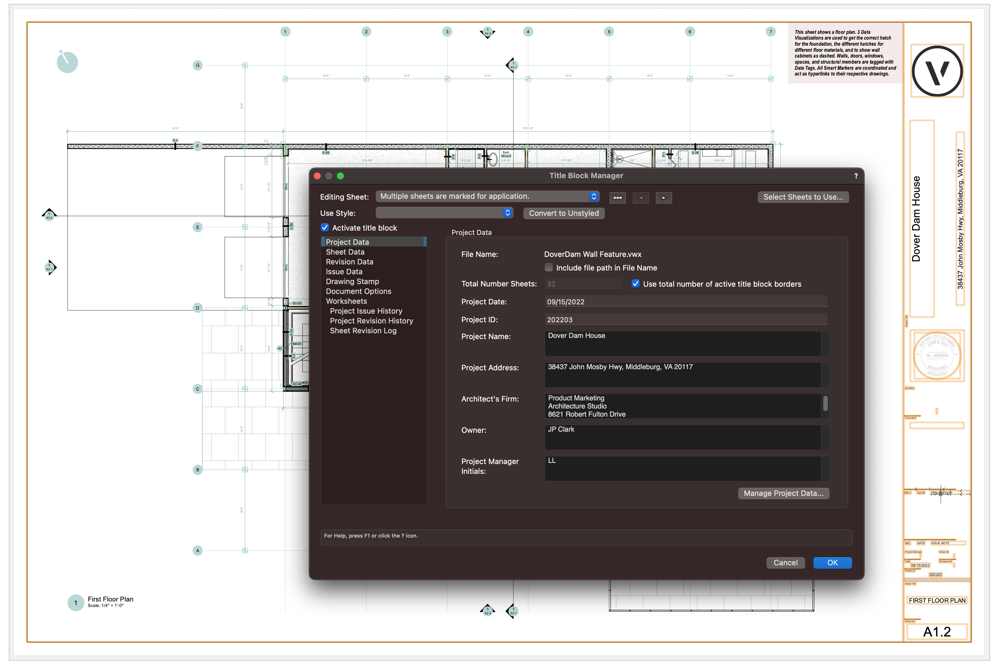

The Title Block Border tool is a game-changer. It goes beyond being just a mere collection of text and lines on sheet layers, as it has important data attached to it that is crucial for any project. This includes the project name, address, and ID, along with essential details like the drawing stamp, revisions, and sheet name.
Titleblock Manager
But that's not all — there are even more settings that allow you to customize the title block even further to fit your specific needs. From adding images to including more text objects, the possibilities are endless. What's more, each text object is linked with the data, making it effortless to include on the title block.
The title block functions as a style, meaning that when you edit the layout, all the sheets will update accordingly. This not only saves you time but also ensures that your entire project stays organized and consistent. Plus, with the Title Block Manager, you can easily input data and select which sheets to edit, whether it's just one or all of them.

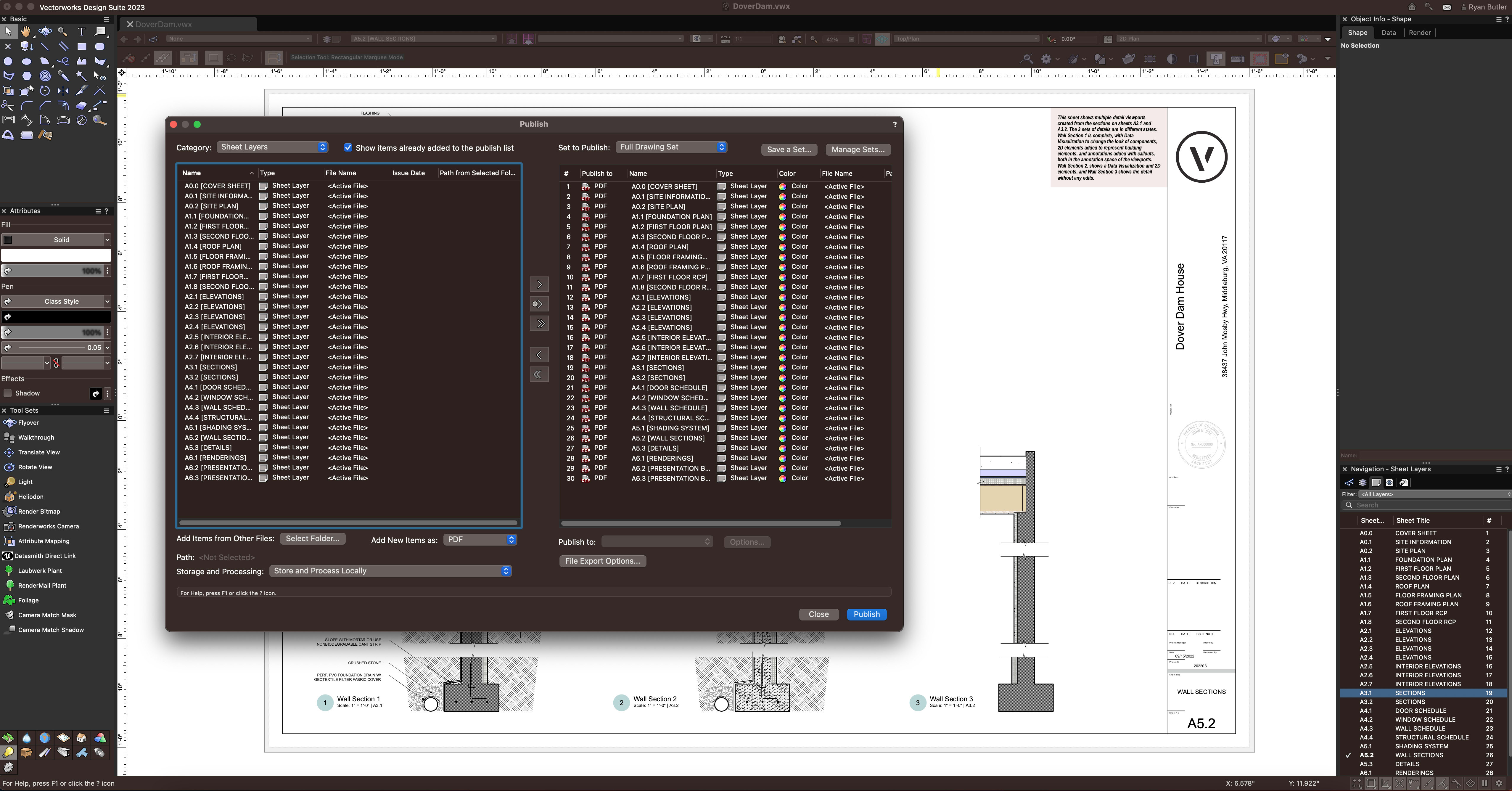

With the batch publishing feature, you can easily select the sheets and saved views you want to publish without having to do it one by one. This saves you a lot of time and effort, making the process more efficient. Publishing will also update your viewports, so you don’t have to go through each sheet to update them before publishing.
The Publish command in Vectorworks can be used to produce a variety of file types, including PDF, DWG, and image file types. Publishing to PDF and DWG formats comes in handy because there will be updates that need to be exchanged with consultants to keep everyone on schedule.
Moreover, there are file export options and PDF settings that you can adjust to your liking. You can choose between grayscale or color, black and white, and even save presets for sheets. The DPI and file size reduction settings are also useful for optimizing the final output while keeping the quality intact.
Publish
