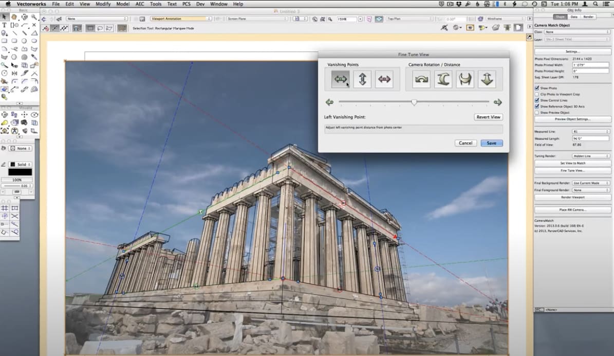

Place a Camera Match reference point. This is simply a 3D object that you place in your model. Do this by clicking the Camera Match tool under the View menu and selecting Place Camera Match Reference. Make sure to select a point you can easily identify in both the photo and your model. You'll be able to rotate the reference object to define the axes in your photo.
Navigate to the sheet layer with your isometric view and enter the annotation space by right clicking and selecting Edit Annotations.
Locate your context photo and insert it. It’s recommended to set photo brightness to something like 30% so you’re able to see control lines in a later step. This setting won’t reflect in the final rendering; it’s simply used to make alignment easier.
Adjust the three sets of perspective control lines, starting with blue (vertical) then red and green. Steps 3 and 4 are demonstrated in the video below.
Add the dimension you measured in the field to the corresponding control line.
Locate the reference point on the photo that corresponds to the reference point you placed in your model earlier. After placing the target, select Set view to match.
Adjust sliders to fine tune the appearance of the model.
Render the viewport. Then, jump back into annotation mode for any necessary final touch-ups such as adding a Camera Match Mask, which functions similarly to the Photoshop mask tool. You can see how this works in the following video.
