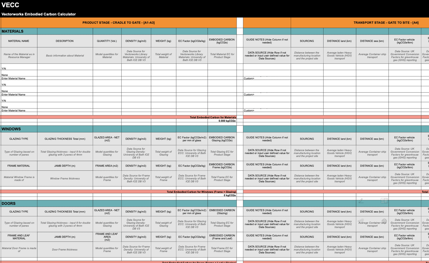

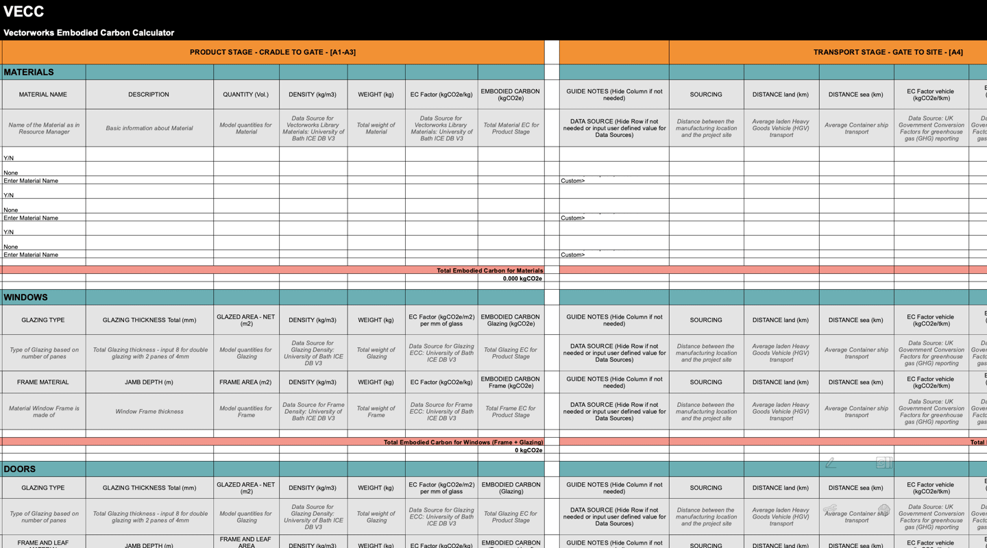

The Vectorworks Embodied Carbon Calculator (VECC)
Designers using Vectorworks Architect will be pleased to know that there’s a tool created specifically for this purpose: the Vectorworks Embodied Carbon Calculator, or “VECC.”
The tool is a pre-formatted worksheet that has built-in formulas to calculate material embodied carbon emissions based on your inputs.
Screenshot 2022-01-21 at 16.07.07
The VECC is organized into columns corresponding to stages of the project’s lifecycle:
  • Product Stage – for tracking embodied carbon emitted from supply, transport, and manufacturing of selected raw materials.
  • Transportation Stage – for tracking carbon emitted from the transportation of products from the manufacturing plant to the project site.
  • Construction Stage – for tracking carbon emitted from any on- or off-site construction-related activities.
  • Replacement Stage – for tracking carbon emissions associated with anticipated replacement of building components.
  • Deconstruction & Demolition Stage – for tracking carbon emissions arising from any on- or off-site deconstruction and demolition activities.
  • Recovery/Recycling Stage – for tracking carbon emissions associated with treatment and processing of materials and components that’re intended to be recovered and reused after the end of the built asset’s lifecycle.
  • Disposal Stage – for tracking carbon emissions arising from disposal of materials and components not expected to be recovered and repurposed, but incinerated or disposed of at a landfill.

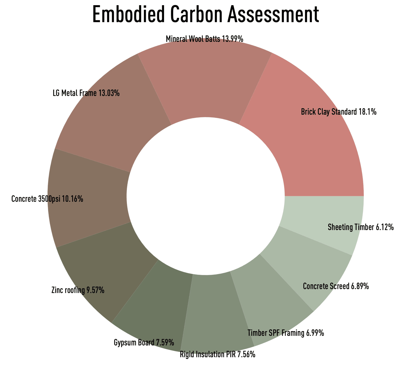

Using Marionette, Vectorworks' algorithms-aided design tool, you can extract data from the VECC to visualize it into a chart. This chart is connected to the data sheet above.
Screenshot 2021-12-08 at 11.48.17
With the VECC and Energos — which is used to calculate energy demand — you’re well set up to complete a holistic carbon emissions assessment.
