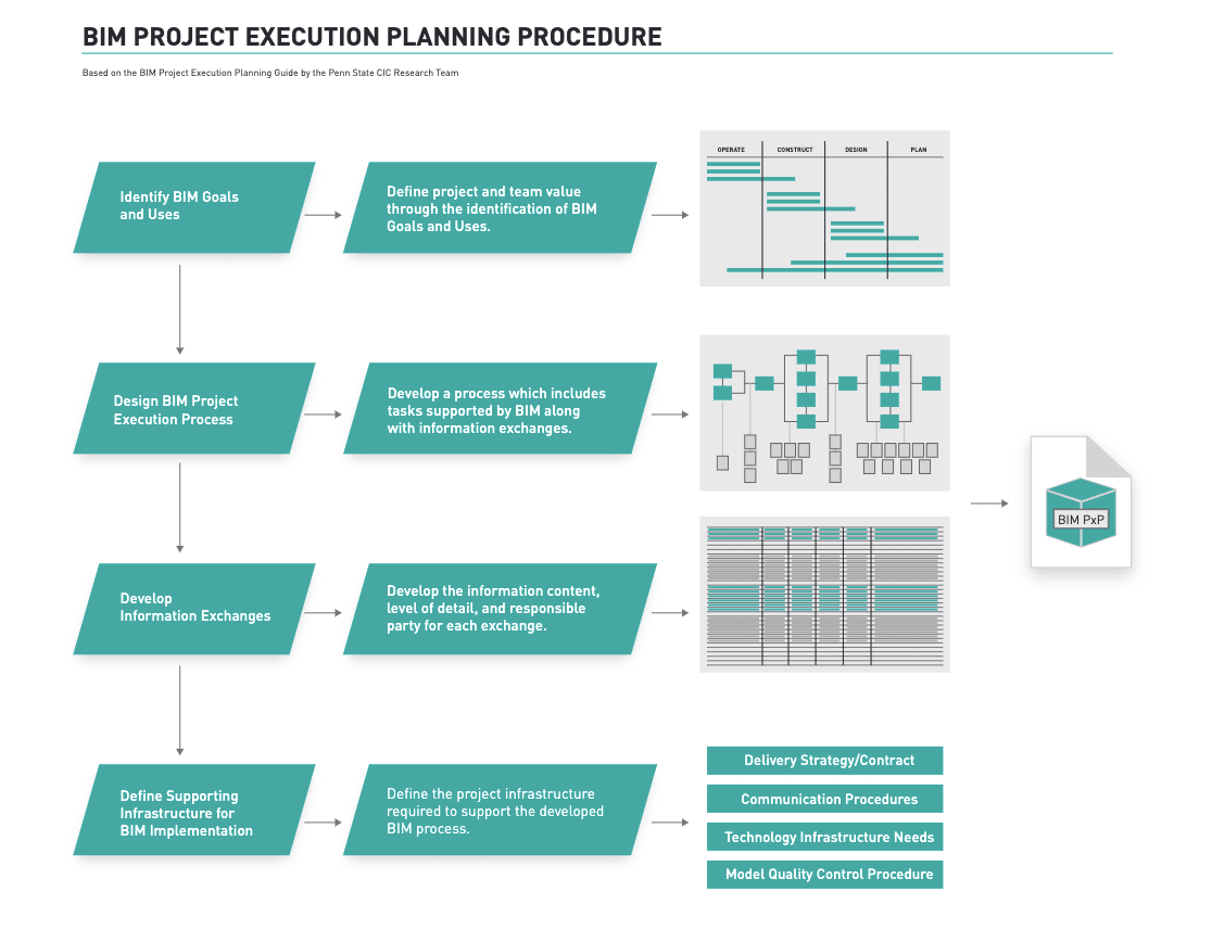

If you’ve had success creating a BIM Execution Plan in the past, you can use that document as a template or starting point, making sure to update it to meet the needs of the current project. If you don’t have a template to start from, visit Penn State’s website for resources on getting started with BIM Execution Plans. The Penn State Computer Integrated Construction (CIC) program’s 2007 research into BIM implementation is still widely referenced today. The UK BIM Framework is another great resource that also aligns with ISO 19650.
From there, follow this list to get started laying out the bulk of the plan.
Afterwards, make sure to perform a mockup file exchange to verify the success of the intended workflow.
