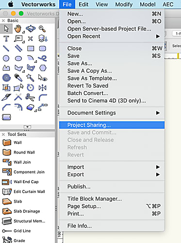

Any existing or new Vectorworks document can be turned into a file that’s ready for Project Sharing. Simply press the Project Sharing command in the File menu.
Project sharing command in Vectorworks

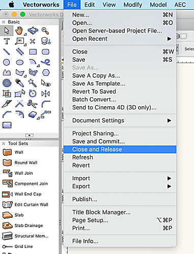

Team members can then “check out” objects, design layers, or sheet layers to work on. It’s not unlike checking out books at a public library. Once an element is checked out, it remains exclusive until a Close and Release command is performed.
Close and release command.

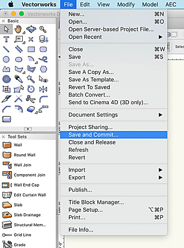

To merge changes back into the overall Project File, use the Save and Commit command in the File menu. This will update the Project File with your changes, and teammates will be able to see your changes in their working files by clicking Refresh.
Update a Vectorworks Project File with the Save and Commit command.

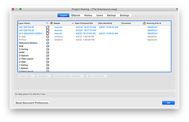

Layers Tab
The Layers tab allows you to see which layers are available, which layers are checked out by others (shown in gray text), and which layers you have checked out yourself (shown in blue text). The project administrator can designate layers as master layers within this tab.
The Laters tab in the Vectorworks Project Sharing dialog box

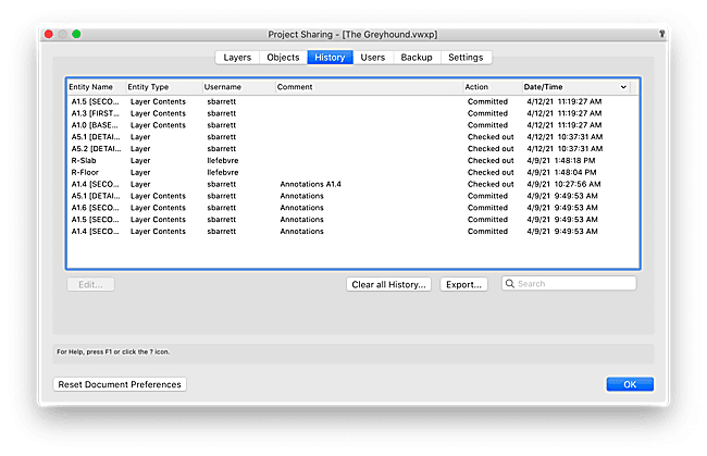

History Tab
The History tab contains a compilation of all change history to the Project File so you can track the multitude of changes that occur in a multiuser environment.
You can search this tab by keyword to find what you’re looking for. The project’s entire history can be exported with the Export command, which will generate a CSV file than can then be imported into data processing applications like Excel or Numbers.
The History tab in the Project Sharing Dialog box.

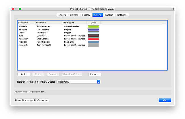

Users Tab
Here you can see a list of the entire project team. The tab will show usernames, full names, permission levels, and associated colors. The project administrator can edits permission levels from this tab.
The Users tab in the Project Sharing Dialog box.
