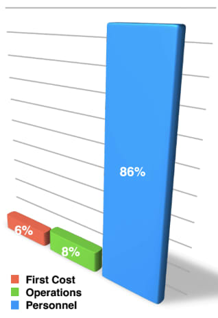

A professor of mine once started a graduate classroom discussion: “What’s the most valuable component of a building?” A lively debate ensued, and eventually we weighed whether a building’s first costs — construction — were outstripped by its operating costs. After some digging, we concluded that for a typical building, operational costs significantly outweighed first costs. Just as we settled on this consensus, our professor added, “And what about the most valuable component of a building — its occupants?” And so in our deliberations we vastly undervalued — economically speaking — a building’s occupants. It turns out that the employment costs alone of a building’s occupants outweigh first and running costs combined by a factor of six or more,
according to a US Forest Service study

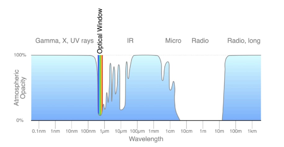

Designers train for years, first in school, then in practice, to understand buildings as complex systems of systems, and then to appropriately apply that knowledge. While the lines we draw and volumes we model and render are all about the materials that buildings are made of, ultimately the function and purpose of a building is to be inhabited by people. And people are the product of adaptive evolution in a particular environment, our planet. One small example: eyes see color the way they do because of a particular tiny window in our atmosphere that allows a very narrow band of electromagnetic energy just below the micrometer wavelength (what we think of as visible light) to easily penetrate to the surface of our world.

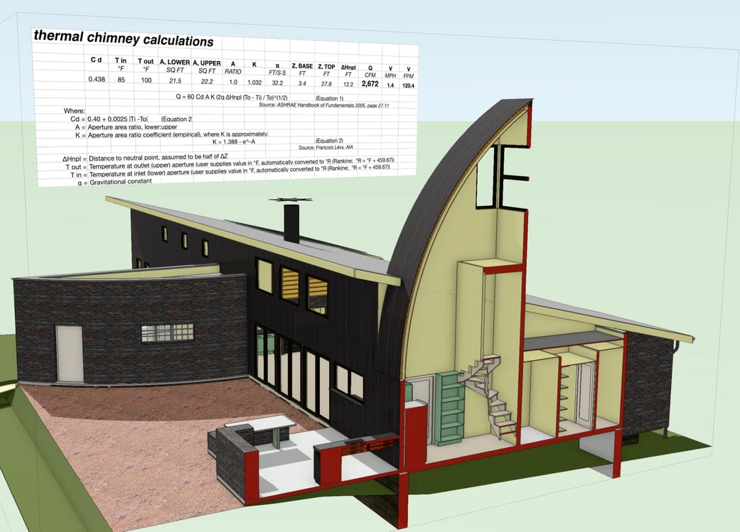

Natural ventilation, in suitable climates and at appropriate times of year, can be a great way to maintain positive indoor air quality and simultaneously reduce energy usage. This is particularly compelling since often the goals of IEQ and energy efficiency can be at odds. Elsewhere I’ve extensively discussed customizing Vectorworks worksheets to estimate airflow rates due to cross ventilation as well as the stack effect of warm air’s natural buoyancy.

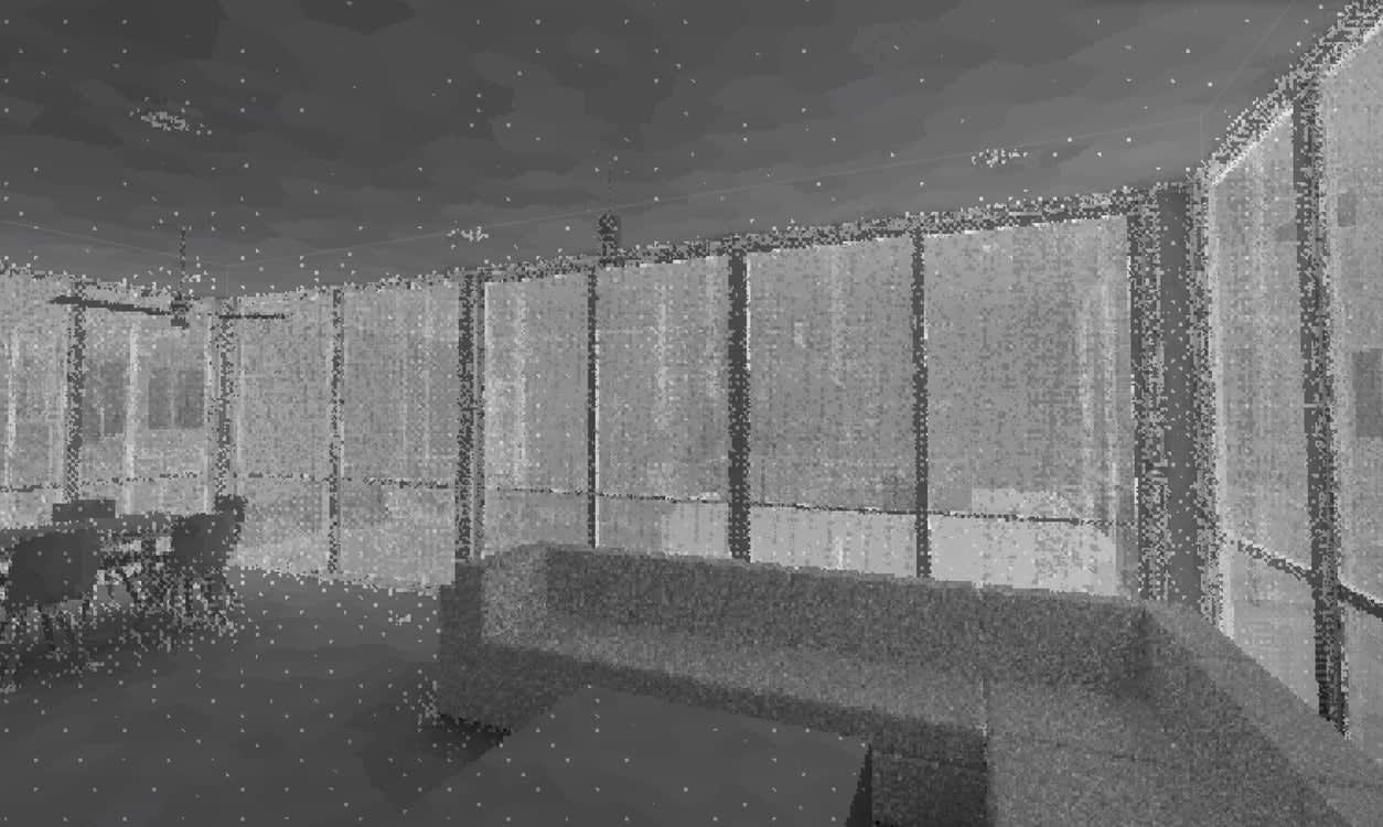

It’s been well established that humans function better in the presence of natural light. If you’re like me and spend too many nights awake in the wee hours, you’re probably aware of the science advising you to recalibrate yourself to natural diurnal rhythms. In your design projects, you can use simple rendering techniques to validate your daylighting strategies.

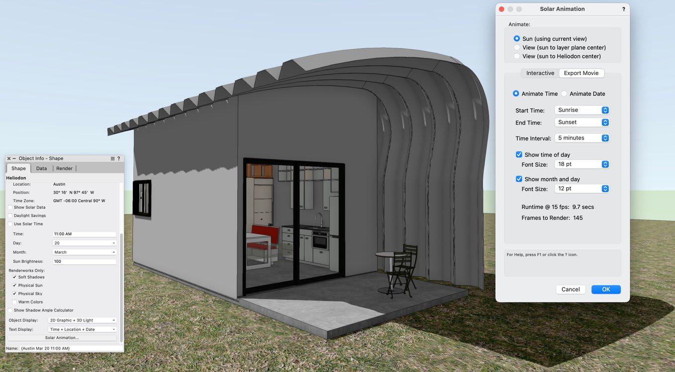

Geolocate your project, insert a Heliodon, and run a series of stripped-down renderings that can quickly provide a sense of the effectiveness of your design.
And, of course, the Heliodon’s solar animation feature is an essential tool for evaluating placement of glazing and designing overhangs.

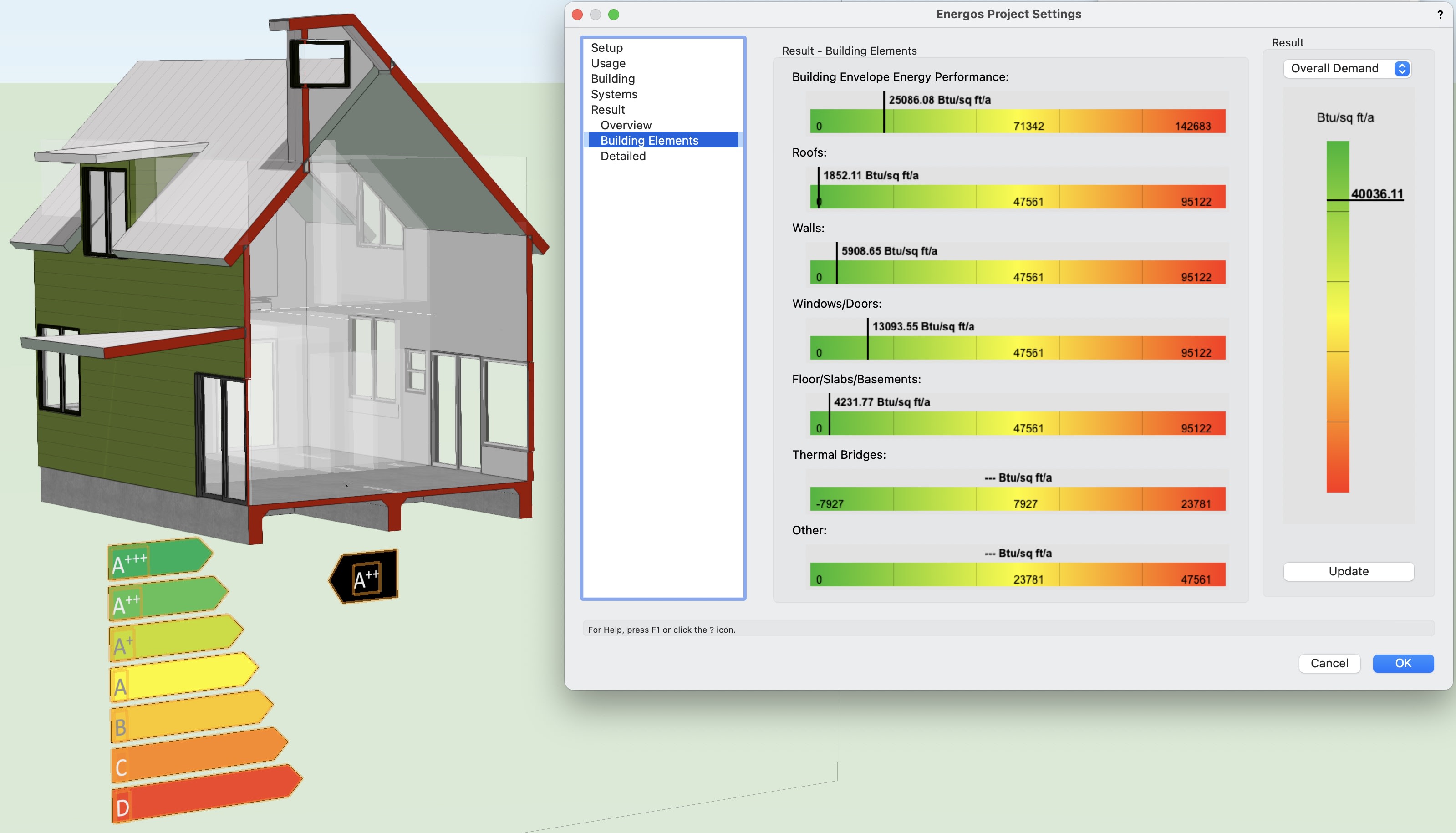

Vectorworks’ Energos suite of tools helps you target energy performance and make decisions to meet those targets. Rather than a comprehensive energy modeling tool (best implemnted late in design), Energos is a Passivhaus-derived calculator that allows you to compare a variety of options to weigh the benefits of a variety of design decisions, from total wall insulation, to airtightness, to window sun exposure, and evaluate where in your project to best devote your efforts.
