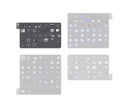

When tailoring your design space in Vectorworks Spotlight, the Workspace Editor is a great place to start. But if you’re looking for even greater levels of personalization to speed up your workflow, we recommend checking out the Smart Options Display.
Using this display keeps your frequently used tools, tool sets, tool modes, and more right next to your cursor while you’re working in your drawing. You’ll no longer need to move your mouse around to locate your Lighting Device tool, rigging tools, or whatever you find yourself using most often. Instead, your focus can stay on your design itself.
The Smart Options Display can be found in the Vectorworks Preferences dialog box. Once opened, select the triggers that help you work faster, and specify which of the available smart options will help you maximize efficiency.
Another way you can make your workspace more custom is by creating templated files where your preferred classes, design layers, sheet layers, and saved views with specific view modes are already predefined.
Creating classes and layers at the start of each project can be time-consuming and tedious. So, once you’ve built out your classes, layers, and views the way you like, select File > Save As Template. You don’t even need to have geometry in your document to save it as a templated file.
