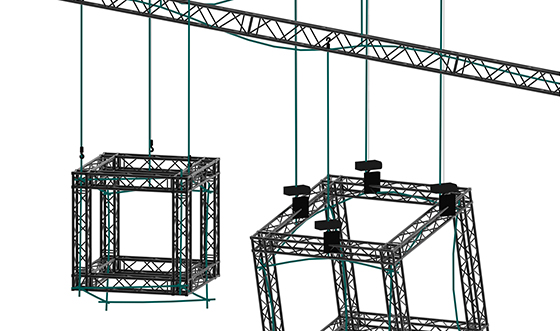

The Braceworks add-on module seamlessly integrates with Vectorworks Spotlight to help you gauge the viability of temporary entertainment structures under load. It analyzes complete 3D structural systems modeled in Spotlight. It supports point- and distributed-load types, straight and curved structural members, and multiple materials. The Finite Element Analysis (FEA) performs static analyses, with results displaying graphically on the model for easy reference. Detailed calculation reports can be created. Models can be exported in DSTV format for collaboration with structural engineers using other FEA software.

When the Braceworks module is installed for Vectorworks Spotlight and Designer, it provides new commands and tools to insert and connect supporting structures (such as trusses and lighting pipes), add hoists and other supports, and then adds loads to the structures.
