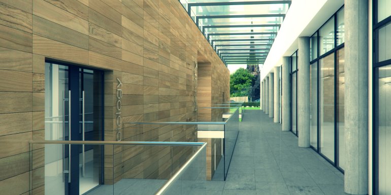

"CINEMA 4D's integration with Vectorworks is extremely valuable to us as it allows the building to be refined in Vectorworks and constantly updated in CINEMA 4D in minimal time during the process," says Oliver. One project in which Franklin Ellis combined Vectorworks software and CINEMA 4D to provide rapid 3D visuals during the design process was for the new Science Priory at Repton School in England.
Notable former students of the leading school span all fields, from author Roald Dahl to Top Gear presenter Jeremy Clarkson, and Adrian Newey, the only designer to have won Constructors Championships with three different Formula One teams. The concept behind the unique Science Priory is to locate classrooms, laboratories, and lecture rooms in a new science building so that the rooms for physics, chemistry, and biology will be in adjacent spaces and will make use of shared resources, such as IT and technical rooms.

Additional resources include a multimedia 'science cave' in which structures can be projected in three dimensions to make it possible for students to examine molecules, channels, organs, and intra-cellular structures close-up. "We needed to produce an animation that visually explains the function of the building and at the same time holds the attention of the audience," recalls Oliver.
"It was decided from the outset that the animation would follow a storyboarded approach rather than simply flying a camera around the spaces. This would allow for more realistic camera movements, the creation of a visual in which the user can engage." One of the main challenges facing Franklin Ellis was controlling the number of polygons within the scene. Architectural scenes are often polygon heavy due to the complexity of foliage and other natural objects coupled with the intricate features of the building itself.
